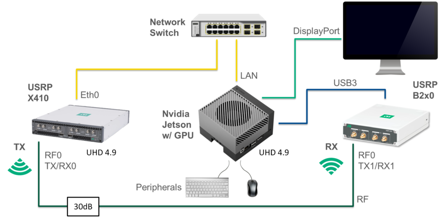

Jetson-Based Embedded Architecture
Jetson-based spectrum sensing architecture using NI USRP B2x0 and X410
In this configuration, an NVIDIA Jetson module serves as the edge processing unit. The Jetson connects to a USRP B2x0 (e.g., B206) over a USB 3.0 interface, acting as the spectrum sensor (receiver). A USRP X410 acts as the transmitter, linked via a LAN switch. A 30 dB attenuator is used between the TX and RX paths to prevent RF front-end saturation during close-proximity transmission.
The Jetson executes the RF data acquisition pipeline and leverages onboard GPU resources to perform high-speed FFTs, signal classification, and real-time metadata tagging. A display, keyboard, and mouse connect directly for standalone operation.
'Jetson System Specifications:
  • Operating System: Ubuntu 22.04 with JetPack 6.2.1
  • UHD Version: 4.9
  • Processor: NVIDIA Jetson AGX Orin 64 GB
This configuration is ideal for low-power, field-deployable sensing nodes where edge inference, minimal latency, and portability are required. The NI-RF Data Recording API runs natively on ARM-based Jetson, ensuring consistent data acquisition across architectures.

Jetson-Based Embedded Spectrum Sensing Setup
  • NI USRP B206 SDR (Receiver)
    • Frequency Range: 70 MHz – 6 GHz
    • Bandwidth: up to 56 MHz
    • Interface: USB 3.0
  • NI USRP X410 SDR (Transmitter)
    • Frequency Range: up to 7.2 GHz
    • Bandwidth: up to 1 GHz per channel
    • Interface: 10 GbE (SFP+)
  • NVIDIA Jetson AGX Orin 64 GB Developer Kit (Edge Host)
    • GPU: 2048-core Ampere GPU
    • Interfaces: USB 3.0, 10 Gb Ethernet
    • OS: Ubuntu 22.04 (ARM64) with JetPack 6.2.1
  • Display and Input Devices
    • Monitor (DisplayPort or HDMI)
    • USB Keyboard and Mouse
  • 30 dB RF Attenuator
    • Protects RX frontend during loopback or close-range transmission
  • Network Switch (Gigabit)
    • Routes LAN traffic between Jetson and X410
  • RF Cables and Antennas or Dummy Load
  • Power Supply for USRP X410 and Jetson
  • USB 3.0 Cable (for Jetson–B206 interface)
