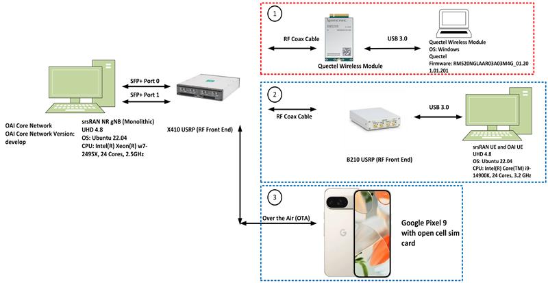

Deployment 1: OAI gNB and CN on the Same Machine
In this setup, both the OAI Core Network (CN) and the OAI NR gNB are hosted on the same physical machine. This configuration is typically used for:
  • Lab-based research and teaching environments
  • Portable demos and proof-of-concept systems
  • Quick-start testbeds for 5G protocol stack development
Architecture Highlights:
  • Compute Node: High-core-count x86 server (e.g., Intel Xeon w7-2495X, 24 cores)
  • Operating System: Ubuntu 22.04
  • Software Stack: OpenAirInterface gNB (monolithic) and 5G Core (AMF, SMF, UPF, NRF, etc.)
  • UHD Version: 4.8
  • RF Front-End: USRP X410 with SFP+ (10/100 Gbps) link
Advantages:
  • Simple setup with fewer network dependencies
  • Easy to debug and deploy
  • Lower hardware requirements

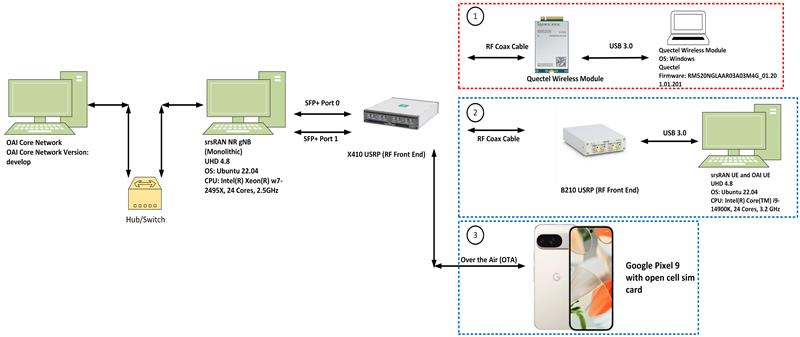

Deployment 2: OAI gNB and CN on Separate Machines
This configuration separates the OAI gNB and CN onto two dedicated physical systems connected via an Ethernet switch. It is ideal for:
  • Research involving modular network slicing, edge cloud integration, or realistic RAN-Core interface behavior
  • Scalable testbeds with high-throughput and isolated workloads
  • Large MIMO, beamforming, or MEC-based deployments
  • gNB Node: Intel Xeon w7-2495X, 24 cores, Ubuntu 22.04
  • CN Node: Separate x86 server, also running Ubuntu 22.04
  • Interconnect: High-speed Ethernet via managed switch
  • RF Front-End: USRP X410 with dual SFP+ for IQ data
Advantages:
  • Higher reliability and scalability
  • Easier to simulate real-world latency, routing, and interface constraints
  • Better performance profiling of CN and gNB independently
Considerations:
  • Requires correct IP addressing, routing, and DNS setup
  • More complex to configure and monitor
Multi-machine deployment with OAI Core Network and gNB on separate hosts. The setup uses a high-speed Ethernet switch and supports flexible UE integration over coaxial and OTA interfaces.

Quectel Wireless Module UE Cable Setup
The diagram in Figure below illustrates the cabling and RF signal routing between the UE system running a Quectel RM520N wireless module and the USRP X410 connected to the OAI gNB. This setup enables direct RF loopback in a controlled lab environment using coaxial connections.
  • USB Connection: The Quectel RM520N is connected to the UE system via a USB 3.0 interface. The host PC runs Windows and interacts with the module through Qualcomm QMI or MBIM drivers.
  • RF Antennas: The module has 4 RF ports (ANT 0–3), which are routed to a 4-way power splitter (ZN4PD1-63HP-S+) to combine the signals.
  • Attenuation: A fixed 40 dB attenuator is inserted after the splitter to protect the downstream USRP RF front end and ensure signal levels remain within a safe operating range.
  • Downstream RF Splitting: The combined RF signal is routed to a 2-way splitter (ZN2PD2-50-S+), which separates it into TX/RX and RX-only paths.
  • USRP Connection: These RF paths are connected to the USRP X410, which is linked to the OAI gNB system over dual SFP+ (10/25 G) links for baseband data transfer and synchronization.

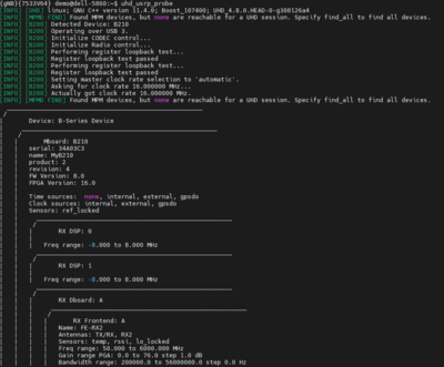

Verify the installation:
uhd_usrp_probe
uhd_find_devices
For more details, see the official UHD GitHub page: https://github.com/EttusResearch/uhd

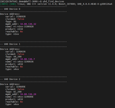

Example output of `uhd_usrp_probe` for USRP B210
Example output of `uhd_find_devices` for N310 and X410

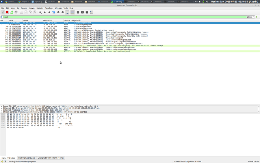

Verifying with Wireshark
Wireshark capture showing successful NGSetupRequest and NGSetupResponse between gNB and AMF.
Wireshark can verify NGAP signaling between the gNB and the Core Network (CN). The interface to monitor depends on your deployment setup:
  • Scenario A: CN and gNB on Separate Machines
    • On the CN machine, start Wireshark and select the oai-cn5g network interface.
    • On the gNB machine, start Wireshark and select the Ethernet interface (e.g., eno1) connected to the CN machine.
    • Start capturing on both to monitor NGAP and related 5G signaling traffic.
  • Scenario B: CN and gNB on Same Machine
    • Start Wireshark and select only the oai-cn5g interface.
    • All internal signaling between gNB and CN containers will be visible on this interface.
Expected Behavior:
  • After the gNB launches, it should initiate an NGAP Setup Request to the AMF.
  • The AMF should respond with an NGAP Setup Response if MCC, MNC, and TAC match.

[INFO] [UHD] ... UHD_4.8.0 ...
[INFO] [B200] Detected Device: B210 (USB 3)

Verifying srsUE Attach and Registration via Wireshark
A Wireshark capture of NGAP and NAS signaling confirms:
  • NG Setup (NGSetupRequest/Response)
  • NAS Registration (InitialUEMessage → Registration Request)
  • Authentication and Security Mode procedures
  • UE Capability exchange
  • Initial Context Setup
  • PDU Session Resource Setup
NGAP and NAS signaling during UE attach and registration.

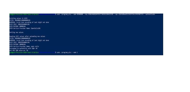

Configuring the SIM Card
If using a modem or COTS handset, a SIM is required (OAI UE softmodem on USRP does not require one).
Open-Cells SIM (ADM code printed on SIM). Read current data: sudo ./program_uicc --adm 1
Example (failure due to wrong ADM length):
No ADM code of 8 figures, cannot program the UICC
Use the correct 8-digit ADM (example): sudo ./program_uicc --adm 0C008080
Successful programming and authentication example: sudo ./program_uicc --adm QC008080 \ --key 8C6A145D419B107F93501CC02255D4C6 \ --opc 1DB7A0E55282194FC145F9B9F184979D \ --authenticate
UICC programming failure due to incorrect ADM length.
Successful UICC programming and 5G AKA authentication.
