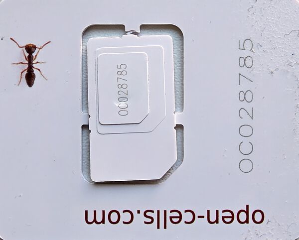

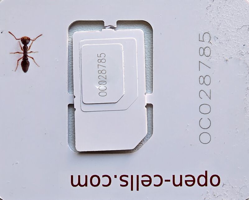

  • SIM Card: The Google Pixel 9 uses a programmable Open Cell SIM card provisioned with the correct PLMN and network parameters to allow registration with the OAI core network.

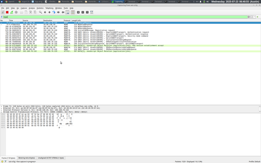

Wireshark Monitoring of OAI CN
Wireshark is a powerful tool used to observe packet exchanges within the OAI CN deployment. Below we show the key steps in using Wireshark.
Upon launching Wireshark, the user must select the appropriate interface to begin capturing packets. In our setup, the interface named "oai-cn5g" represents the internal Docker network where all core services are communicating. Select the interface `oai-cn5g` to capture traffic between CN components, as shown in the figure listed below.
Selecting the oai-cn5g interface in Wireshark
Once the capture starts, Wireshark displays packets exchanged between the core network functions such as AMF, SMF, NRF, AUSF, and others. This is useful for verifying proper message flow and debugging. Reference the figure shown below.
Live capture showing HTTP2, TCP, and PFCP traffic between CN containers

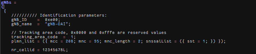

gNB Configuration File Setup for OAI with USRP X410
The gNB configuration must match your local system and hardware. Configuration files are in the ~/openairinterface5g/targets/PROJECTS/GENERIC-NR-5GC/CONF/ folder.
Edit the following sections of this file, per the figures shown below.
MCC, MNC, and SST configuration in PLMN section
  • Set mcc = 208, mnc = 95, and sst = 1 to match the Core Network (CN) slice configuration.
  • nr_cellid = 12345678L can be any unique value.

Then open Wireshark, select the interface connected to the CN, and observe the NGAP packets.

Verifying with Wireshark
Wireshark is used to verify the NGAP signaling between the gNB and the Core Network (CN). The interface to monitor depends on your network configuration. The figure listed below shows a Wireshark capture showing successful NGSetupRequest and NGSetupResponse between gNB and AMF
Scenario A: CN and gNB on Separate Machines
  • On the CN machine, select the oai-cn5g interface in Wireshark.
  • On the gNB machine, select the Ethernet interface (e.g., eno1) toward the CN.
Scenario B: CN and gNB on Same Machine
  • Select only the oai-cn5g interface (all internal CN–gNB signaling is visible).
The expected behavior is:
  • After startup, the gNB sends an "NGAP Setup Request" to the AMF.
  • Then, the AMF responds with NGAP Setup Response" if the MCC, MNC, and TAC parameters match.
Ensure that the MCC, MNC, SST match between gNB config and CN config.yaml.
  • Verify that the TAC (Tracking Area Code) matches on both sides.

Ensure the following values are synchronized between the OAI UE and CN:
  • imsi, key, and opc match the subscriber profile in the UDM DB/YAML.
  • dnn (e.g., oai or default) matches SMF config.
  • nsai (sst and optional sd) matches the network slice.

Verifying UE Attach and Registration via Wireshark
Wireshark is used to inspect and verify the signaling exchange between the UE, gNB, and Core Network during the 5G attach and registration procedure. The figure listed below captures NGAP and NAS messages exchanged during a successful UE attachment using the OAI UE and gNB connected to the OAI 5G Core.
The process begins with the NGSetupRequest and NGSetupResponse messages to establish the NG interface. This is followed by the UE initiating registration using the InitialUEMessage which encapsulates a NAS Registration Request. The core responds with a sequence of NAS security procedures, including Authentication Request, Authentication Response, Security Mode Command, and Security Mode Complete.
Once NAS security is established, the UE capabilities are exchanged using the UECapabilityInformation message. The AMF then sends the InitialContextSetupRequest, followed by the UE's InitialContextSetupResponse. Finally, a PDU Session Resource Setup Request and corresponding PDU Session Resource Setup Response are exchanged, completing the end-to-end attach and session setup.
This packet trace confirms successful synchronization, NAS registration, and PDU session establishment for end-to-end IP connectivity.
Wireshark capture showing the NGAP and NAS signaling during UE attach and registration. Key steps: NG Setup, Initial UE Message, Authentication, Security Mode, Capability Exchange, Context Setup, and PDU Session Setup

Configuring the SIM Card
When using a 5G wireless modem module or a COTS handset, a SIM card is required. (If a USRP runs the OAI UE softmodem, then a SIM card is not required.)
The SIM used in this reference architecture is from Open-Cells, and is shown in the figure listed below. The ADM code is printed directly on the SIM itself.
Open-Cells programmable SIM card (ADM: 0C028785)
Insert the nano SIM into the reader/writer and plug it into the UE computer. Use program_uicc from Open-Cells (link) to read and program the SIM.
    sudo ./program_uicc --adm 0C028785

    sudo ./program_uicc --adm 0C028785 --imsi 001010100001101 --key 0C0A34601D4F07677303652C0462535B --opc 63bfa50ee6523365ff14c1f45f88737d --authenticate --noreadafter
    Existing values in USIM
    ICCID: 8933006110000000785
    USIM IMSI: 2089201000001785
    PLMN selector: 0x02f8297c
    Operator Control PLMN selector : 0x02f8297c
    Home PLMN selector : 0x02f8297c
    USIM MSISDN: 00000785
    USIM Service Provider Name: open cells
    Setting new values
    Succeeded to authentify with SQN: 64
    Set HSS SQN value as: 96
    sudo ./program_uicc --adm 0 C028785
    USIM IMSI: 001010100001101
    PLMN selector: 0x00f1107c
    Operator Control PLMN selector : 0x00f1107c
    Home PLMN selector : 0x00f1107c
    Setting new values
    No Key or not 32 char length key
    No OPc or not 32 char length key
    Reading UICC values after uploading new values
The above listing demonstrates the process of reprogramming a programmable SIM card.
  • Initial values: The SIM originally contained IMSI 2089201000001785 and PLMN selector 0x02f8297c. The Service Provider Name was shown as "open cells".
  • Programming new values: The command provides a new IMSI (001010100001101), along with a valid 128-bit authentication Key and OPc. Authentication succeeded, with the sequence number (SQN) updated from
   64 to 96, confirming that the SIM accepted the new credentials.
  • Verification after update: A subsequent read of the SIM shows the new IMSI and updated PLMN selector (0x00f1107c). Since no Key or OPc values were passed in this second command, the tool reported:
This does not indicate an error. It only indicates that no new keys were provided for update.
  • Outcome: The SIM is now reprogrammed with a new IMSI and valid authentication parameters, making it suitable for use in 4G/5G testbeds (e.g., Open5GS, srsRAN, or OAI).
Ensure that the values being programmed into the SIM card match the corresponding values entered in the SQL database on the CN machine. The values of primary importance are listed in the table below.

Wireshark Trace Analysis: Dual UE Registration and PDU Session Establishment
The figure listed below presents a Wireshark capture filtered with the NGAP protocol, showcasing the successful registration and session setup of two UEs over a 5G Standalone (SA) network. The trace includes both NGAP and NAS signaling exchanged between the gNB (10.88.136.29) and the 5GC (192.168.70.132).
Wireshark capture showing NGAP procedures for dual UE connection
The main stages observed in the trace are as follows:
  • NG Setup Procedure:
    • NGSetupRequest from gNB to AMF, initiating the connection.
    • NGSetupResponse from AMF to gNB, confirming the connection.
  • UE Registration Procedures:
    • InitialUEMessage, Authentication Request/Response, and Security Mode Command/Complete are exchanged for NAS authentication and security.
    • Two separate UEs go through this process, indicating a multi-UE test scenario.
  • UE Capability Exchange:
    • UECapabilityInfoIndication is sent from the gNB to AMF.
  • PDU Session Establishment:
    • The AMF initiates PDU Session Resource Setup Request to the gNB.
    • The gNB responds with PDU Session Resource Setup Response}.
    • PDU Session Establishment Accept is observed in JSON/NAS payloads.
  • Error Handling:
    • One occurrence of Authentication Failure (Synch failure) is observed and immediately retried.
The trace confirms that both UEs are successfully authenticated and registered with the 5G Core Network, and are able to establish PDU sessions, and are interacting with both control plane (NGAP/NAS) and data plane (JSON PDU content).

  1. Insert OAI Test SIM
Insert a custom test SIM card with the following parameters:
  • MCC (Mobile Country Code): 001
  • MNC (Mobile Network Code): 01
  • PLMN: 00101 (test network)
