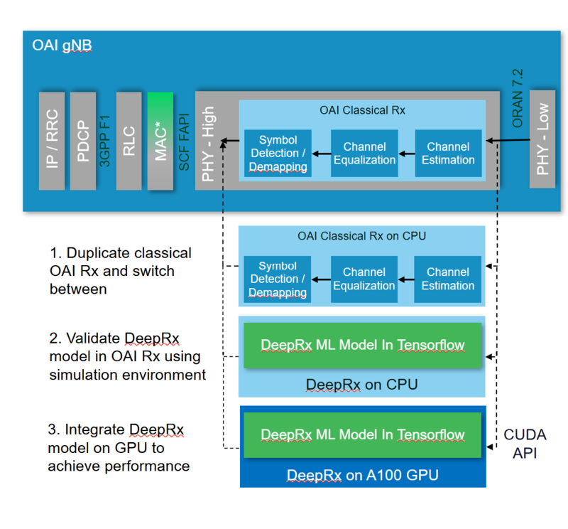

Real-Time Benchmarking Platform
To validate the performance of the neural receiver in real hardware, the prototype integrates:
  • The OAI real-time 5G protocol stack (complete core, RAN, and UE) running on commodity CPUs.
  • NI USRP SDR hardware as the RF front-end.
  • An optional O-RAN Near-RT RIC (via FlexRIC) integration.
  • Neural receiver inference performed on a GPU (e.g., Nvidia A100, RTX 4070, RTX 4090), accessed via TensorFlow RT C-API for seamless integration within OAI.
This setup enables a direct comparison between the traditional receiver baseline against the neural receiver in an end-to-end real-time system.

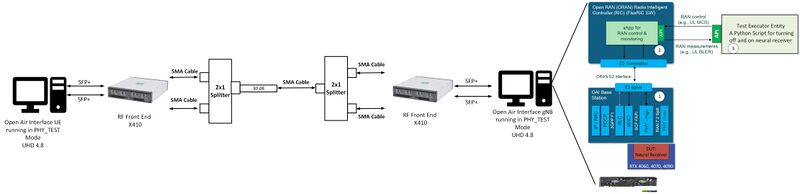

The USRP X410 is connected to the host computer using a single QSFP28 100 Gbps Ethernet link, or using a QSFP28-to-SFP28 breakout cable, which provides four 25 Gbps SFP28 Ethernet links. On the host computer, a 100 Gbps or 25 Gbps Ethernet network card is used to connect to the USRP.
The USRP X410 devices are synchronized with the use of a 10 MHz reference signal and a 1 PPS signal, distributed from a common source. This can be provided by the OctoClock-G (see here and here for more information).
For control and management of the USRP X410, a 1 Gbps Ethernet connection to the host computer is needed, as well as a USB serial console connection.
Further details of the hardware configuration will be discussed later in this document.

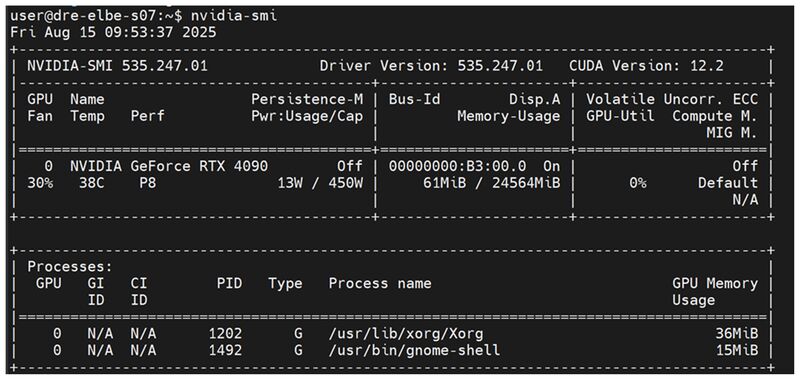

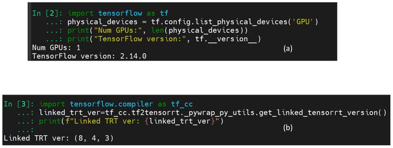

Software Overview
The software stack running on the computers used in this implementation are as listed below.
  • Ubuntu 22.04.5, running on-the-metal, and not in any Virtual Machine (VM)
  • UHD version 4.8.0.0
  • Nvidia drivers version 535
  • Nvidia CUDA version 12.2
  • TensorFlow 2.14

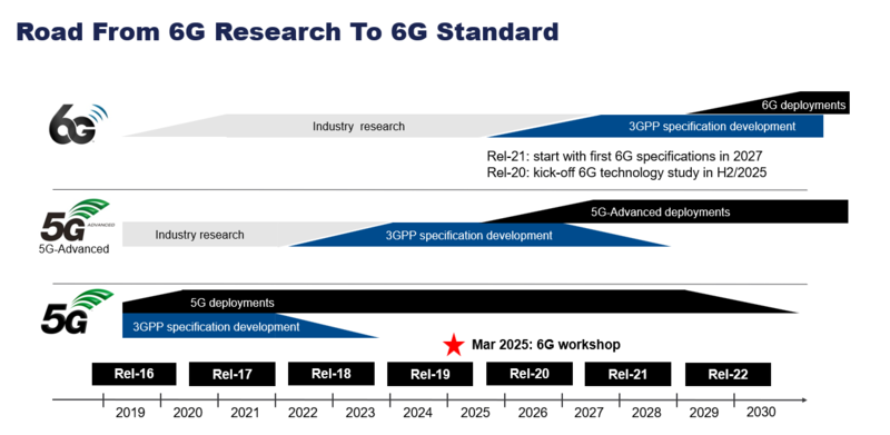

5G To 6G Roadmap
The figure listed below illustrates the expected timeline from ongoing 5G research through to the first 6G deployments.
  • 5G (Release-16 to Release-18): 3GPP initiated 5G specification development in Release-15 and Release-16, followed by commercial deployments from 2019 onward. Work on Release-17 and Release-18 (2021 to 2024) extends 5G capabilities in areas such as URLLC, industrial IoT, and positioning.
  • 5G-Advanced (Release-18 to Release-20): Industry research and specification development converge to define 5G-Advanced features. Deployments are expected around 2025 to 2027, focusing on improved energy efficiency, AI/ML-native functions, and expanded NTN integration.
  • 6G (Release-20 onward): Formal 6G technology studies will begin with Release-20 in H2 2025, marked by the first official 6G workshop in March 2025. Standardization of 6G specifications is planned for Release-21 in 2027, with early 6G deployments projected for the end of the decade (around 2030).
Roadmap from 6G research to standardization. The timeline shows the progression from 5G and 5G-Advanced to 6G, aligned with 3GPP releases and industry milestones.
The figure above highlights the transition from 5G deployments to the research and standardization cycles of 5G-Advanced and 6G. This staged process ensures backward compatibility, while paving the way for disruptive innovations in spectrum use, AI-native networks, and new application domains.
As shown in the figure above, the transition from 5G to 6G is not only a matter of spectrum expansion and new use cases, but also of embedding AI-native functionalities into the air interface itself. Release-20 (2025) will mark the start of 6G technology studies, providing an opportunity to evaluate disruptive physical layer techniques such as Neural Receivers. These receivers directly integrate deep learning models into the detection chain, enabling them to cope with nonlinearities, hardware impairments, and the extreme bandwidths expected in FR3 and sub-THz bands. By Release 21 (2027), as 6G specifications are defined, neural receivers and other AI-based PHY innovations will play a crucial role in realizing the vision of AI-native 6G, where intelligence is embedded from the physical layer up to the application layer.

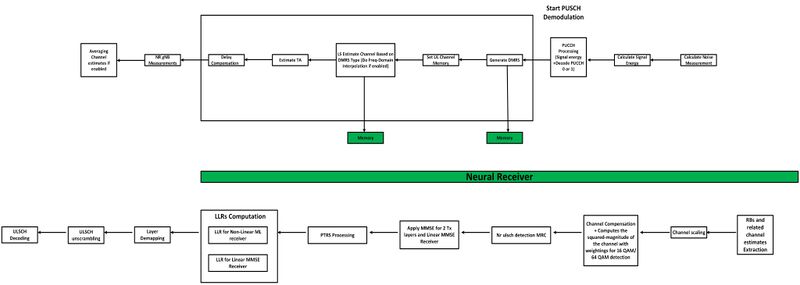

Typical Neural Receiver Architecture
A commonly used architecture like DeepRx treats the resource grid as a 2D input, similar to an image, where time and frequency correspond to axes. This allows the use of convolutional neural networks (CNNs), recurrent neural networks (RNNs), or transformer-based models.
  • Input: Complex-valued OFDM resource grid, with pilot and data symbols.
  • Layers: Convolutional or attention-based layers extract spatial and temporal features.
  • Output: Recovered symbols or bits with associated confidence scores.

  • Software stack and runtime optimization: Covers validation of TensorFlow, NVIDIA TensorRT, and TF C-API installation, as well as disabling unnecessary system services (e.g., updates, GNOME display manager) that may negatively impact performance.

Listing of checks for system bring-up and set-up
Check Item Command Desired Output
Operating System hostnamectl Ubuntu 22.04.5
BIOS version sudo dmidecode -s bios-version Check system vendor for latest version
Verify GPU lspci | grep -i nvidia Example: RTX 4090 may appear as 17:00.0 VGA compatible controller: NVIDIA Corporation Device 2684 (rev a1)
Nvidia driver version and CUDA version nvidia-smi Nvidia driver version 535.183.01 and CUDA version 12.2
GPU Load nvidia-smi Load in percentage

Testbed Equipment List
The table listed below details the bill of materials used in the experimental 5G testbed setup. The infrastructure is divided into separate blocks for data recording, gNB, UE, and RF hardware.
The host computers for the gNB and UE are each implemented on a Dell Precision 5860 server, which has an Intel Xeon W7-2495X CPU (24 physical cores with turbo frequency of 4.8 GHz), and 25 Gbps Ethernet network cards. The gNB system also includes an Nvidia RTX 4090 GPU to accelerate AI-based signal processing workloads. The UE system uses a much less powerful GPU, as no AI acceleration is needed.
Both gNB and UE connect to USRP X410 radios via a Mellanox Nvidia ConnectX-5 MCX512A-ACAT network card (the Intel X710-DA2 may also be used), and QSFP28-to-SFP28 breakout cables.
The OctoClock-G distributes a common 10 MHz reference signal and 1 PPS signal across all USRP devices.
This hardware configuration ensures support for wideband operation, supporting channel bandwidths from 40 MHz to 100 MHz, and multiple MIMO layers, enabling advanced AI-driven signal processing and performance evaluation in a realistic testbed.

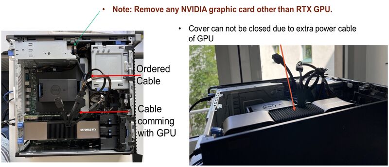

Caution on GPU Installation
On some systems, the chassis may not be able to be fully closed after installing the GPU. This is true for the Dell 5860, where after installing the Nvidia RTX 4090 GPU, the chassis can no longer be fully closed because of limited clearance between the power connectors for the GPU and the lid of the chassis. Reference the photo shown below.
Be sure to remove any other GPUs installed in the system, other than the primary Nvidia RTX 4090 GPU. This ensures optimal power delivery and avoids resource conflicts.
For compact systems, it is recommended to use custom low-profile or angled power cables with the GPU to reduce space usage. If frequent access is required, maintain the system in an open or semi-open configuration. Consider future integration with 2U or 4U rackmount servers that have dedicated GPU clearance and improved airflow management.
Left: Installed RTX 4090 GPU with ordered power cable. Right: Cover cannot be closed due to cable protrusion.

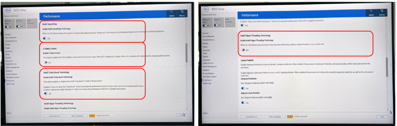

The figure listed below shows the BIOS settings from the Dell Precision 5860 Tower server that are recommended for achieving stable and consistent performance when running the real-time physical-layer processing. The BIOS settings for the Dell 3680 are similar. These optimizations ensure that the CPU runs at full performance and avoids unpredictable latency caused by power-saving modes.
Recommended BIOS configuration on the Dell Precision 5860 for high-performance Linux operation
Each of the areas highlighted in the red boxes is explained below.
  • Intel SpeedStep (Enable): This feature allows the CPU to automatically adjust voltage and frequency as needed. Keeping it enabled with a performance governor in Linux lets the processor use higher
frequencies when possible (Turbo mode).
  • C-State Control (Disable): Disabling C-states prevents the CPU from entering low-power or idle modes (C1, C2, etc.). This keeps all cores active and ready to execute instructions without delay, which is
essential for low-latency wireless tasks.
  • Intel Turbo Boost Technology (Enable): This setting allows the CPU to increase its frequency above the base clock when the thermal and power budget permits. It improves processing throughput for demanding workloads such as baseband signal processing.
  • Intel Hyper-Threading Technology (Disable): Turning off hyper-threading ensures that each physical core runs only one thread. This avoids unpredictable delays that occur when two threads share the
same core and switch contexts, leading to more deterministic timing in real-time applications.
Some servers may not include a direct P-state configuration menu in the BIOS. In such cases, P-states are automatically managed by the CPU and operating system to balance performance and power usage. When running real-time or 5G workloads, it is recommended to use the performance CPU governor in Linux and verify the configuration using tools like cpupower or turbostat .

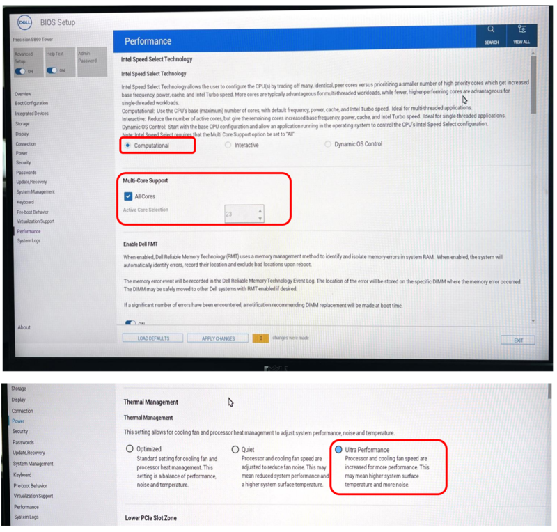

The figure listed below shows additional BIOS options on the Dell Precision 5860 system. These settings focus on fully activating all CPU cores, optimizing frequency behavior, and maintaining consistent thermal performance.
Additional BIOS optimization settings on Dell Precision 5860 Tower for high-performance operation
  • Intel Speed Select Technology → Computational Mode: This option prioritizes all CPU cores for maximum performance rather than balancing power and efficiency. Setting it to Computational ensures that each core operates at the highest available frequency during demanding workloads.
  • Multi-Core Support → All Cores: This option ensures that all physical CPU cores are active and available for processing. This is important for workloads like signal processing or AI inference where multiple threads are used in parallel.
  • Power → Thermal Management → Ultra Performance: This mode increases the CPU cooling fan speed and power envelope to sustain higher frequencies for longer durations. It helps prevent performance throttling under heavy thermal load conditions. Note that in some BIOS, this option is found under Thermal Config → Thermal Mode → Performance, instead of under the Power menu.
After applying BIOS changes, always perform a system reboot to ensure all parameters take effect.

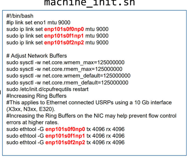

Configuration of High-Speed Ethernet Interfaces
To achieve the maximum data throughput between the servers and the USRP radios, the high-speed 10 Gbps and/or 100 Gbps Ethernet interfaces must be properly configured. We recommend that each user create a short shell script on every Linux server, in order to automate this setup.
This script should define the correct network interface names, adjust the MTU size (typically 9000 for jumbo frames), and configure the read/write socket buffer sizes and ring buffer parameters for optimal performance. Running this script at startup ensures that all network settings are restored after each system reboot, maintaining consistent high-speed communication between the servers and the USRP devices. Note the various network settings shown in the figure listed below.
Configuration steps for optimizing high-speed Ethernet interfaces using the utility script
Identify all network interfaces by running:
   ifconfig
Go to the work directory:
   cd $HOME/workarea
Open the configuration script:
   sudo nano machine_init.sh
Update the interface names (e.g., enp101s0f0np0 , enp101s0f1np1 , etc.) to match your system, and then save and exit the file.
You can manually invoke the script with as shown below.
   sudo $HOME/workarea/machine_init.sh
The script performs various optimization actions. It sets the MTU (Maximum Transmission Unit) value to 9000 for each Ethernet interface to enable jumbo frames to improve throughput, it adjusts read/write network socket buffers for higher data transfer efficiency, and it increases the ring buffer sizes on the network card to reduce packet drops at high data rates. These settings can be performed with the commands listed below. These optimizations ensure stable high-speed data transfer between USRP devices and servers, reduce latency and prevents packet loss during high-throughput streaming, and maintain deterministic network behavior for real-time applications.
   sudo sysctl -w net.core.wmem_max=125000000
   sudo sysctl -w net.core.rmem_max=125000000
   sudo sysctl -w net.core.wmem_default=125000000
   sudo sysctl -w net.core.rmem_default=125000000
   sudo /etc/init.d/cpufrequtils restart
   sudo ethtool -G enp101s0f0np0 tx 4096 rx 4096
   sudo ethtool -G enp101s0f1np1 tx 4096 rx 4096
   sudo ethtool -G enp101s0f2np2 tx 4096 rx 4096

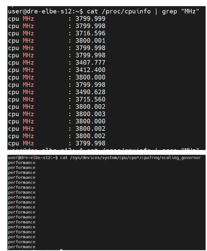

Check that all CPU cores are running at their maximum clock frequency:
   cat /proc/cpuinfo | grep "MHz"
To continuously monitor the CPU clock frequency:
   watch -n1 "grep '^[c]pu MHz' /proc/cpuinfo"
Verify that all CPU cores are configured to use the performance governor:
   cat /sys/devices/system/cpu/cpu*/cpufreq/scaling_governor
The output should show performance for all CPU cores.
Check that Linux kernel boot parameters include power-state control options:
   cat /proc/cmdline
The expected output should contain:
   intel_pstate=disable processor.max_cstate=1 intel_idle.max_cstate=0 idle=poll
You should see output that is similar to what is shown in the figure listed below.
Verifying CPU clock frequencies, scaling governors, and power-state parameters on Linux servers
If a CPU frequency drops more than 1 GHz below the expected maximum, it indicates that power-saving or frequency-scaling features are still active.
Ensure that the BIOS options such as C-State control are disabled and that the Linux CPU governor is set to performance .
Reboot the system after any BIOS or GRUB configuration changes to ensure that they take effect.
Initial Integration Concept of an AI/ML Real-Time DUT into Test System
The goal of this integration is to incorporate an AI/ML-based neural receiver (DeepRx) into the OAI physical layer, enabling real-time evaluation and comparison with the classical OAI receiver chain. The steps for this integration are summarized below.
Initial integration workflow for incorporating DeepRx neural receiver into the OAI test system
  • Understand the OAI PHY Receiver Structure: Begin by analyzing the existing OAI receiver pipeline and identifying where the neural receiver (DeepRx) will replace or operate in parallel with the classical receiver chain.
  • Duplicate and Replace Classical Rx Chain: Duplicate the traditional OAI Rx chain and replace one of the receiver instances (e.g., Rx2) with the \textbf{DeepRx Neural Receiver}. This allows direct comparison between the conventional and AI-based approaches.
  • Validate DeepRx in Simulation Environment: Validate the DeepRx model within OAI using the simulation mode:
    • Use the non-real-time OAI simulation mode on CPU for model validation.
    • Integrate the DeepRx model in the C++ OAI codebase using TensorFlow C-API.
    • Check the scaling of input and output power across the receiver chain.
  • Integrate DeepRx on GPU for Real-Time Processing: After validation, move DeepRx to GPU for real-time performance evaluation:
    • Compare data transfer options between CPU and GPU (e.g., 22.6~µs latency).
    • Use proper memory configuration to maximize data transfer throughput.
    • Validate inference time of DeepRx for 2.5~MHz and 5~MHz OAI bandwidth modes.
    • Integrate DeepRx into OAI and test under different bandwidth configurations.
    • Optionally reduce DeepRx model complexity to improve inference speed.
  • Compare AI Receiver and Classical Receiver: Run side-by-side experiments to compare the performance of the DeepRx neural receiver against the traditional OAI receiver chain in terms of accuracy, latency, and stability.
The integration workflow establishes a clear path for introducing AI/ML-based components into real-time wireless PHY processing. By starting with CPU-based simulation and gradually shifting to GPU-based real-time inference, the setup ensures stable validation, measurable performance gains, and reproducible benchmarking within the OAI framework.
Integration of Neural Receiver into the OAI Physical Layer Processing
The neural receiver (DeepRx) replaces the traditional MMSE-based detection and LLR computation modules inside the OAI physical-layer processing. This section shows the signal processing flow and how the AI model interfaces with existing OAI components.
Integration of Neural Receiver (DeepRx) into the OAI receiver chain
The standard OAI receiver follows the 5G NR uplink physical layer pipeline, starting from demodulation reference signal (DMRS) generation and ending with decoding of the uplink shared channel (ULSCH). To enable AI-based inference, the DeepRx neural receiver is inserted between the channel estimation and the LLR computation modules.
The processing flow is as described below.
  1. Uplink Channel Estimation: The gNB estimates the channel from DMRS symbols using a least-squares (LS) approach. The estimated channel is stored in memory for later reuse.
  1. Neural Receiver Insertion: The DeepRx module is invoked after the conventional channel compensation stage. It receives preprocessed IQ samples and channel state information as inputs. The TensorFlow C-API interface is used to call the trained DeepRx model from within the C-based OAI code, allowing real-time inference directly on GPU.
  1. Soft Bit (LLR) Generation: Based on the detected symbols, DeepRx outputs log-likelihood ratios (LLRs), replacing the classical linear MMSE LLR computation block. For fallback mode, the traditional MMSE-based LLR computation remains available for comparison.
  1. Post-processing: After inference, the LLRs are passed to the existing OAI modules, such as Layer Demapping, ULSCH Unscrambling, and ULSCH Decoding, without any modification to higher layers.
There are several advantages to this approach.
  • Seamless Integration: The DeepRx module interfaces with OAI through the TensorFlow C-API, avoiding major restructuring of the PHY code.
  • GPU Acceleration: By running inference on the NVIDIA A100 and RTX GPUs, the system achieves real-time decoding performance for 5 MHz and 10 MHz channel bandwidths.
  • Flexibility: Users can switch between neural and classical receivers through a run-time flag ( use_neural_rx=1 ).
  • Benchmarking: Enables direct comparison of BER/BLER and inference time between ML-based and conventional algorithms.
The DeepRx TensorFlow model is loaded once during initialization using the function </code> TF_LoadSessionFromSavedModel() </code>. Input and output tensors are pre-allocated to minimize latency. Data movement between CPU and GPU is handled through pinned memory buffers to reduce transfer overhead. The OAI logging system records inference latency, memory usage, and achieved BLER for post-analysis.
End-to-End Testbed Setup with OAI, USRP X410, and Neural Receiver Integration
The figure listed below illustrates the complete end-to-end (E2E) setup used for integrating and evaluating an AI/ML-based neural receiver within an OpenAirInterface (OAI) 5G system. The setup includes both the OAI gNB (base station) and UE (user equipment) running in PHY TEST mode, interconnected via RF front ends (USRP X410) and managed through an Open RAN control and monitoring framework.
E2E testbed setup for integrating the Neural Receiver into the OAI system using USRP X410 and RIC control
  • OAI UE and gNB: Both the OAI UE and gNB instances run in PHY_TEST using UHD 4.8 drivers. This configuration ensures a controlled environment focused on physical-layer data exchange, without the need for higher-layer signaling.
  • RF Front Ends (USRP X410): Two USRP X410 radios are used as RF front-ends, one connected to the gNB, and the other connected to the UE. These devices handle digital-to-analog and analog-to-digital conversion, enabling over-the-air (or cabled) transmission of 5G NR signals.
  • Interconnection and Attenuation: The two X410 units are connected through a series of 2×1 RF splitters and a 30 dB attenuator. This controlled attenuation emulates realistic signal propagation conditions while avoiding hardware saturation. All RF links are realized using SMA cables.
  • Ethernet Connectivity: Each server connects to its respective X410 via SFP+ 10 Gbps Ethernet links, ensuring low-latency data transfer and real-time IQ data streaming.
The Software and Control Architecture is segmented into the following components.
  • OAI Base Station Stack: The OAI gNB stack implements the standard 5G protocol layers (PHY, MAC, RLC, PDCP, and higher). Within the physical layer, the Neural Receiver (DeepRx) is integrated as a Device Under Test (DUT), replacing or running in parallel with the classical OAI receiver chain. The gNB server runs on Nvidia RTX GPUs (tested with RTX 4060, 4070, and 4090), leveraging CUDA for acceleration.
  • Open RAN Control via RIC: A FlexRIC-based Radio Intelligent Controller (RIC) communicates with the gNB through the E2 interface. The RIC hosts xApps that enable dynamic control and monitoring of the RAN. For example, the xApp can read metrics such as uplink BLER or MCS and issue reconfiguration commands (e.g., enabling or disabling the neural receiver).
  • Test Executor Entity: A Python-based Test Executor script interacts with the RIC via APIs to automate experiments. It toggles the Neural Receiver on and off, collects performance metrics (e.g., throughput, latency, BLER), and logs system responses for later analysis.
The workflow proceeds as follows:
  1. The OAI gNB and UE exchange baseband IQ samples in PHY_TEST mode through the USRP X410s.
  1. The neural receiver processes received symbols either on the CPU or the GPU, depending on the system configuration.
  1. The RIC monitors the real-time performance and can trigger control actions through its xApp.
  1. The test executor automates benchmarking, toggling the neural receiver, and recording measurements for analysis.
This modular testbed enables reproducible evaluation of AI-driven physical-layer components within a real 5G OAI environment, supporting both closed-loop and open-loop testing scenarios.

Verify the driver installation.
   nvidia-smi
The output should list your GPU, such as A100 or RTX 4090, with correct driver and CUDA versions.
Next, install the CUDA Toolkit.
   sudo apt install nvidia-cuda-toolkit
   sudo reboot
Once the installation is complete, confirm that nvidia-smi <code> correctly displays the GPU utilization and shows CUDA version 12.2. Check compatibility with TensorFlow 2.14 and TensorRT C-API. Validate that GPU acceleration works in user-space applications (e.g., TensorFlow or PyTorch).

Then, verify the TensorFlow GPU access. Open an IPython session and run these commands.
   import tensorflow as tf
   physical_devices = tf.config.list_physical_devices('GPU')
   print("Num GPUs:", len(physical_devices))
   print("TensorFlow version:", tf.__version__)
If Num GPUs is 1 or more, then TensorFlow can successfully detect the GPU.
A sample output is shown below.
   Num GPUs: 1
   TensorFlow version: 2.14.0
Next, verify the TensorRT version linked with TensorFlow. To confirm that TensorRT is linked correctly within TensorFlow, run the commands listed below.
   import tensorflow.compiler as tf_cc
   linked_trt_ver = tf_cc.tf2tensorrt._pywrap_py_utils.get_linked_tensorrt_version()
   print(f"Linked TRT ver: {linked_trt_ver}")
If you see output as shown below, then TensorFlow is correctly configured with TensorRT libraries.
   Linked TRT ver: (8, 4, 3)
You can exit the IPython session after successful verification using the exit() command.

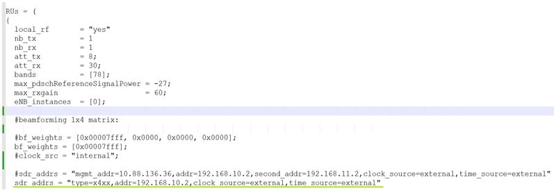

USRP IP configuration within the OAI gNB configuration file
Open the gNB configuration file in the OAI directory.
   nano targets/PROJECTS/GENERIC-NR-5GC/CONF/gnb.band78.sa.fr1.106PRB.1x1.usrpx410_3300.conf
Within the configuration file, locate the RUs section. Update the sdr_addrs field according to the connected USRP model and network topology.
\noindent Example RU configuration block:
   RUs = (
       local_rf                      = "yes";
       nb_tx                         = 1;
       nb_rx                         = 1;
       att_tx                        = 8;
       att_rx                        = 30;
       bands                         = [78];
       max_pdschReferenceSignalPower = -27;
       max_rxgain                    = 60;
       eNB_instances                 = [0];
       bf_weights                    = [0x00007fff];
       sdr_addrs                     = "type=x4xx,addr=192.168.10.2,clock_source=external,time_source=external";
Next, open the gNB configuration file.
Change the IP address of the USRP in the RU section. Note that no change is required if using default IP addresses for the USRP, and it would then typically be ready to use.
   sdr_addrs = "type=x4xx,addr=192.168.10.2,second_addr=192.168.11.2,clock_source=external,time_source=external"
Ensure that the addr field matches the IP assigned to the USRP device.
The clock_source } and time_source should both be set to external when using the OctoClock-g, which is recommended.
For laboratory setups without an OctoClock-G or without any GPS synchronization, these values can be set to internal .

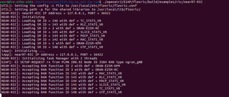

The FlexRIC
The FlexRIC (Flexible RAN Intelligent Controller) is used in the OAI testbed for enabling near-RT RIC functionalities, such as RAN monitoring and control through the E2 interface. It must be built after compiling the OAI gNB with E2 agent support.
To build the OAI gNB with E2 Agent Support, follow the procedure listed below.
If not already done, build the gNB with E2 agent and RF simulation libraries.
   sudo ./cmake_targets/build_oai -w USRP --gNB --build-e2 --build-lib nrscope --ninja
Next, prepare the FlexRIC Source code. The FlexRIC/E2 Agent source is included as a submodule inside the OAI repository.
   cd lti-6g-sw_oai-5g-ran/openair2/E2AP/flexric
Next, follow the additional setup instructions in the flexric/README.md document.
Next, check and install SWIG.
First check the current SWIG version.
   swig -version
If the version is below 4.1, then remove it.
   sudo apt-get purge --auto-remove swig
Install all the required dependencies and build SWIG version 4.1, if needed.
   sudo apt update
   sudo apt install libpcre2-posix2 libpcre2-dev
   cd ~/workarea
   git clone https://github.com/swig/swig.git
   cd swig
   git checkout release-4.1
   ./autogen.sh
   ./configure --prefix=/usr/
   make -j8
   sudo make install
Next, check and configure the GCC version. The FlexRIC does not support GCC 11, so ensure that the system is using GCC 10 or 12.
   gcc --version
If needed, install and configure a supported version of GCC.
   sudo apt -y install gcc-10 g++-10 gcc-12 g++-12
   sudo update-alternatives --install /usr/bin/gcc gcc /usr/bin/gcc-10 10
   sudo update-alternatives --install /usr/bin/g++ g++ /usr/bin/g++-12 12
   sudo update-alternatives --config gcc
Now, you can build the FlexRIC.
First, install the required dependencies.
   sudo apt install libsctp-dev cmake-curses-gui
Then, build the FlexRIC itself.
   mkdir build && cd build
   cmake ..
   make -j8
   sudo make install
You can use make -j8 for faster parallel compilation on multi-core systems.
Ensure that SWIG version 4.1 and a supported GCC version (10 or 12) are configured before building.

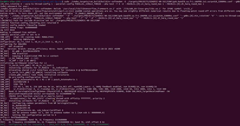

Running the gNB
After building and configuring the OAI gNB, it can be executed in different physical layer test modes, either using the Neural Receiver, the Traditional Receiver, or the RF simulator.
If the gNB was built with FlexRIC, ensure that the FlexRIC service is running before starting the gNB.
To run the gNB using the Neural Receiver, follow the procedure listed below. Note that the Neural Receiver is enabled by default. The test executor can select between the Neural and Traditional receiver dynamically.
   sudo ./cmake_targets/ran_build/build/nr-softmodem -O ./targets/PROJECTS/GENERIC-NR-5GC/CONF/gnb.band78.sa.fr1.106PRB.1x1.usrpx410_3300MHz.conf --gNBs.[0].min_rtxtime 6 --usrp-tx-thread-config 1 \
--parallel-config PARALLEL_SINGLE_THREAD --phy-test -T 6 -d --MACRLcs.[0].ul_harq_round_max 1 --MACRLcs.[0].dl_harq_round_max 1 --disable_gnb_neural_rx 0
This configuration launches the gNB in Neural Receiver mode, utilizing GPU acceleration and the TensorFlow API for real-time inference.
Use this mode when validating AI-based PHY receiver integration (DeepRx or NeuralRx), or when GPU-based inference is available (e.g., RTX 4060, 4070, 4090, or A100).
To run the gNB using only the Traditional Receiver, follow the procedure listed below. This mode disables the Neural Receiver, allowing operation without GPU or TensorFlow initialization.
   sudo ./cmake_targets/ran_build/build/nr-softmodem -O ./targets/PROJECTS/GENERIC-NR-5GC/CONF/gnb.band78.sa.fr1.106PRB.1x1.usrpx410_3300MHz.conf --gNBs.[0].min_rtxtime 6 --usrp-tx-thread-config 1 --parallel-config PARALLEL_SINGLE_THREAD --phy-test -T 6 -d --MACRLcs.[0].ul_harq_round_max 1 --MACRLcs.[0].dl_harq_round_max 1 --disable_gnb_neural_rx 1
The "--disable_gnb_neural_rx 1" option forces the traditional receiver to be used by default. The TensorFlow API is skipped, saving GPU resources. This mode is ideal for debugging or quick smoke tests where neural processing is not required.
The "--disable_gnb_neural_rx 0" option enables normal operation, and the Neural Receiver is active by default. If the flag is omitted, then the Neural Receiver is the default and can still be toggled by the test executor.
To run the gNB using the RF Simulator, follow the procedure listed below. In this mode, OAI runs a simulated radio connection between the gNB and UE (no real RF hardware). This is useful for initial validation and debugging before connecting physical USRPs.
   sudo ./cmake_targets/ran_build/build/nr-softmodem -O ./targets/PROJECTS/GENERIC-NR-5GC/CONF/gnb.band78.sa.fr1.106PRB.1x1.usrpx410_3300MHz.conf --rfsimulator.serveraddr server --parallel-config PARALLEL_SINGLE_THREAD --phy-test -T 6 -d --MACRLcs.[0].ul_harq_round_max 1 --MACRLcs.[0].dl_harq_round_max 1
For more details about the RF Simulator, reference the OAI Simulation Mode documentation located here.
Ensure that the correct configuration file path matches the band and USRP model in use.
When testing with Neural Receiver, verify GPU initialization and TensorFlow C-API loading before runtime.
OAI UE Server Performance Optimization
Detailed configuration steps for optimizing CPU, BIOS, and network interface performance were already covered in previous sections. These steps ensure that the testbed achieves maximum throughput and deterministic timing behavior for real-time PHY and AI workloads. In summary:
  • BIOS settings should disable power-saving features and hyper-threading, while enabling Intel SpeedStep and Turbo Boost.
  • Linux system tuning should include fixed CPU frequency scaling (performance governor) and restricted C-states (C0 only).
  • Network interfaces connected to USRPs must be configured with MTU = 9000 for jumbo frame support and enlarged socket buffers using sysctl parameters to support high-rate IQ streaming.
All setup commands are provided in the accompanying initialization scripts machine_init.sh and ue_init.sh, which can be executed after each system reboot.

Running the OAI gNB
The first step in the execution pipeline is to start the OAI gNB in PHY test mode. This mode is useful for validating the physical layer, verifying the neural receiver integration, and checking RF synchronization with the connected UE or channel emulator. The gNB is launched using the nr-softmodem binary built under the LTI 6G branch with TensorFlow C-API support.
   sudo ./cmake_targets/ran_build/build/nr-softmodem -O ./targets/PROJECTS/GENERIC-NR-5GC/CONF/gnb.band78.sa.fr1.106PRB.1x1.usrpx410_3300MHz.conf --gNBs.[0].min_rxtxtime 6 --usrp-tx-thread-config 1 --parallel-config PARALLEL_SINGLE_THREAD --phy-test -T 6 -d --MACRLCs.[0].ul_harq_round_max 1 --MACRLCs.[0].dl_harq_round_max 1
Upon execution, the gNB initializes the baseband PHY, MAC, and RLC layers, loads the UHD driver, and detects the attached USRP X410. The system prints detailed logs confirming PHY configuration, PRB allocation, numerology, frequency parameters, and TensorFlow framework initialization. An example of a successful gNB bring-up is shown in the figure listed below.
OAI gNB bring-up in PHY test mode
The terminal output confirms successful initialization of the OAI gNB operating in Band 78 (3.31968 GHz, 30 KHz SCS) using the USRP X410. The TensorFlow C-API library (libtensorflow_framework.so.2) is dynamically linked, enabling the neural receiver module. The gNB configures PHY parameters such as transmission amplitude (TX_AMP = 519), numerology, and HARQ contexts, and affinitizes PHY worker threads to CPU cores for deterministic scheduling.
The gNB runs in stand-alone mode with the Neural Receiver enabled by default. In this mode, data samples from the PHY layer are passed to the TensorFlow runtime for real-time inference. Subsequent components such as FlexRIC and xApp build upon this active gNB instance to enable real-time control and monitoring.

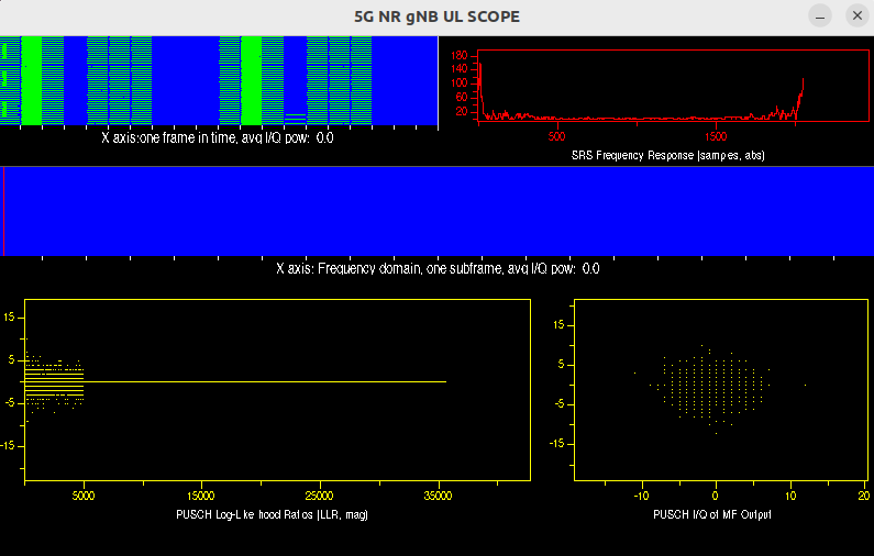

5G NR gNB UL Scope Visualization
Once the OAI gNB is successfully initialized in PHY test mode, the user can launch the built-in UL Scope to visualize real-time uplink physical layer performance. This visualization is particularly useful for verifying RF synchronization, constellation mapping, and signal demodulation quality from the UE.
The figure shown below shows the 5G NR gNB Uplink Scope output when the UE transmits PUSCH data frames in Band 78. The scope window provides four main diagnostic panels that correspond to different domains of PHY-layer signal analysis:
  • Top Left (Time-Domain Power Map): Displays the averaged received power across time frames. The presence of green-blue stripes indicates properly received PUSCH allocations, confirming active uplink transmission and symbol-level synchronization.
  • Top Right (SRS Frequency Response): Shows the magnitude of the Sounding Reference Signal (SRS) across subcarriers. This helps in assessing the uplink channel frequency selectivity and verifying correct estimation of the channel response.
  • Bottom Left (PUSCH LLR Values): Represents the computed Log-Likelihood Ratios (LLRs) from the demodulated PUSCH symbols. A well-distributed pattern around the horizontal axis indicates balanced bit reliability, while outliers or skewed patterns suggest distortion or incorrect MCS settings.
  • Bottom Right (PUSCH Constellation Diagram): Displays the in-phase and quadrature (I/Q) points after matched filtering. The tight clustering of symbols confirms proper demodulation and synchronization. A dispersed or rotated pattern would typically indicate phase misalignment or timing offset.
OAI gNB Uplink Scope Visualization
The scope illustrates real-time PUSCH reception quality and frequency-domain response at the gNB side. The upper panels depict SRS-based frequency estimation and time-domain received power, while the lower panels show LLR magnitude distribution and PUSCH constellation for uplink demodulation validation.
This visualization confirms that the PHY layer is functioning correctly and that uplink demodulation, equalization, and neural receiver integration are operating under expected conditions. In the subsequent subsection, we proceed with enabling the FlexRIC controller to monitor and manage the gNB behavior dynamically.
Running the FlexRIC Controller
After verifying the gNB operation and PHY-layer performance, the next step involves launching the FlexRIC near-Real-Time (nearRT) RIC. The RIC acts as a programmable control plane entity that interfaces with the gNB through the E2 Application Protocol (E2AP), enabling external control and telemetry collection via xApps.
The FlexRIC instance is executed from the "flexric/build/examples/ric/" directory using the following command.
   openair2/E2AP/flexric/build/examples/ric/nearRT-RIC
The figure listed below illustrates the terminal output upon successful initialization of the FlexRIC nearRT-RIC.
The startup log confirms the following items.
  • Configuration Setup: The RIC loads the configuration file from "/usr/local/etc/flexric/flexric.conf" and sets up shared libraries from "/usr/local/lib/flexric/".
  • IP Binding: The RIC binds to the local loopback interface at IP address 127.0.0.1 with default port numbers 36421 (RIC) and 36422 (xApp interface).
  • Service Model Initialization: Multiple Service Models (SMs) are loaded successfully. Each SM corresponds to a specific control or telemetry function, for example:
      • MAC_STATS_V0: collects MAC-layer KPIs.
      • RLC_STATS_V0: gathers Radio Link Control metrics.
      • PDCP_STATS_V0: monitors PDCP throughput and latency.
      • SLICE_STATS_V0: manages network slicing configurations.
      • TC_STATS_V0: tracks traffic control performance.
      • ORAN-E2SM-RC and ORAN-E2SM-KPM: implement standardized ORAN E2 Service Models for RAN Control and KPI Measurement.
  • E2AP Association: The FlexRIC receives an E2 SETUP REQUEST from the gNB, confirming successful registration of all supported Service Models. Each "RAN function ID" listed (e.g., 2, 3, 143–148) corresponds to an individual SM instance.
FlexRIC nearRT-RIC Initialization
The RIC binds to the loopback IP address, loads multiple Service Models (SMs), and establishes an E2AP session with the gNB. This confirms that the control and monitoring channel between the RIC and gNB is operational.
Once initialized, the nearRT-RIC remains active to receive RAN telemetry, trigger control actions, and host various xApps that can dynamically manage gNB resources (e.g., slicing, QoE, or scheduling policies). In the next section, we proceed to configure and execute the xApp gRPC service for higher-layer interaction.

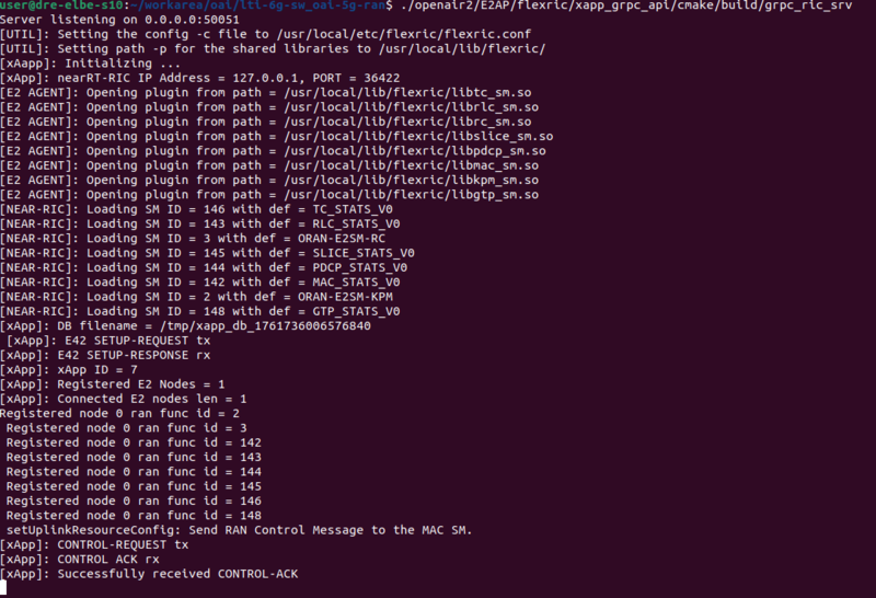

Running the xApp gRPC Service
Once the FlexRIC nearRT-RIC is operational and the gNB is registered under its E2 Node list, the next step is to launch the xApp gRPC Service. This service acts as the interface between the RIC and higher-layer xApps, enabling control, monitoring, and decision-making through standardized gRPC APIs.
The xApp gRPC service is executed from the "xapp_grpc_api" build directory as follows:
   ./openair2/E2AP/flexric/xapp_grpc_api/cmake/build/grpc_ric_srv
The figure listed below shows the terminal output of a successful gRPC server initialization.
The sequence of operations is as follows:
  • Initialization: The server binds to the host interface at port \texttt{50051} and loads the FlexRIC configuration file from "/usr/local/etc/flexric/flexric.conf". Shared libraries corresponding to each Service Model (SM) are then dynamically loaded from "/usr/local/lib/flexric". This ensures compatibility with all registered RAN functions.
  • Service Model Linking: The xApp reuses the same set of Service Models (MAC_STATS_V0, RLC_STATS_V0, PDCP_STATS_V0, SLICE_STATS_V0, TC_STATS_V0, GTP_STATS_V0, etc.) loaded by the FlexRIC. This linkage allows the xApp to monitor per-layer KPIs and issue control commands.
  • E2 Node Registration: The log confirms that one E2 Node (the OAI gNB) is detected and registered with multiple RAN function IDs (2, 3, 142–148), corresponding to ORAN-compliant E2SM service models.
  • Database Initialization: The xApp generates a temporary database file (e.g., \texttt{/tmp/xapp\_db\_1761736006576840}) to store RAN function mappings and maintain session state.
  • Control Procedure: The xApp initiates a control procedure named "SetupLinkResourceConfig" to send a RAN control message to the MAC SM. The log line "Successfully received CONTROL-ACK" confirms that the control message was correctly acknowledged by the gNB via FlexRIC.
xApp gRPC Service Initialization and Control Exchange
The gRPC server loads Service Models, connects to the FlexRIC nearRT-RIC, registers available RAN functions, and executes a RAN control message exchange (CONTROL-REQUEST/CONTROL-ACK) with the MAC Service Model.
After this step, the system is ready to host intelligent xApps capable of dynamic policy enforcement (e.g., traffic steering, QoE-driven scheduling, or power control) using the gRPC interface to the FlexRIC.

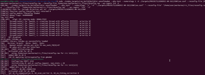

Running the OAI Soft UE in PHY Test Mode
Once the gNB, FlexRIC, and Neural Receiver modules are active, the next step is to launch the OAI Soft UE to complete the end-to-end 5G link setup in PHY Test Mode. The UE connects directly to the gNB without a core network (CN) and synchronizes using the provided RRC configuration files.
The UE is started using the following command:
   sudo ./cmake_targets/ran_build/build/nr-uesoftmodem --phy-test --numerology 1 -O ./targets/PROJECTS/GENERIC-NR-5GC/CONF/ue.conf --reconfig-file /home/user/workarea/rrc_files/reconfig.raw --rbconfig-file /home/user/workarea/rrc_files/rbconfig.raw --ue-rxgain 114 -E
The figure listed below shows the console output corresponding to a successful UE initialization and connection.
OAI Soft UE Initialization and Connection
The UE successfully applies configuration from the gNB, activates SRB and DRB channels, and transitions to the "NR_RRC_CONNECTED" state, confirming successful PHY-level attachment.
  • Initialization Phase: The log lines showing multiple "threadCreate()" calls confirm the creation of UE processing threads responsible for PHY and MAC operations. The message "library libldpc.so successfully loaded" indicates that the LDPC decoder (for 5G NR) is correctly linked.
  • RRC Configuration and Setup: The UE applies configuration parameters received from the gNB through the lines "Applying CellGroupConfig from gNodeB" and "Added DRB to UE 0". These confirm that the UE's RLC, MAC, and PDCP layers have been successfully initialized.
  • Successful Connection: The key message "Received reconfigurationWithSync" followed by "State = NR_RRC_CONNECTED" indicates that the UE has synchronized and established an RRC connection with the gNB. This marks a fully functional PHY Test mode setup, enabling uplink and downlink channel measurements and validation.

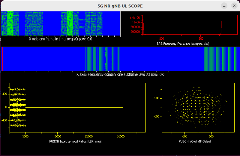

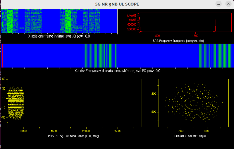

5G NR gNB Uplink Visualization with Neural Receiver
Once both the gNB and OAI Soft UE are successfully initialized, and the Neural Receiver has been enabled, then the gNB graphical interface ("nr_ul_scope") can be used to visualize the uplink (UL) channel and decoding performance in real time. This visualization is part of the OAI monitoring utilities and is automatically launched when the "--nrscope" flag is enabled during gNB execution.
  • Top Left Panel (Time Domain Signal): Displays the received uplink IQ samples over time, showing frame-wise power variations. The clear bursts correspond to PUSCH (Physical Uplink Shared Channel) transmissions from the UE.
  • Top Right Panel (SRS Frequency Response): Illustrates the Sounding Reference Signal (SRS) channel frequency response used for uplink channel estimation. This provides insights into frequency-selective fading and link stability.
  • Middle Panel (Frequency Domain Representation): Shows the frequency-domain mapping of received symbols, indicating the spectral occupancy of the UE signal.
  • Bottom Left (Log-Likelihood Ratios (LLRs)): Presents the computed soft information before decoding, helping assess the reliability of bit decisions within the LDPC decoder. The concentration of LLR values indicates good SNR and effective demodulation by the Neural Receiver.
  • Bottom Right (Constellation Plot (MF Output)): Shows the equalized modulation constellation (e.g., QPSK, 16-QAM). A clean, tight clustering of points demonstrates that the Neural Receiver has successfully performed channel equalization and interference mitigation.
5G NR gNB UL Scope with Neural Receiver Enabled
The 5G NR gNB UL Scope with Neural Receiver Enabled provides a real-time visualization of uplink IQ samples, frequency-domain response, Log-Likelihood Ratios (LLR), and modulation constellation after successful UE connection and Neural Receiver activation.
The Neural Receiver replaces traditional MMSE equalization with a learned inference model that operates on GPU, leading to improved robustness under non-linear channel distortions and interference conditions. The stability of the constellation and reduced noise dispersion in LLR plots confirm successful inference and decoding.

Commands to Invoke gNB, FlexRIC, xApp and Python Script
Invoking gNB
    cd workarea/oai/lti-6g-sw_oai-5g-ran sudo ./cmake_targets/ran_build/build/nr-softmodem -O ./targets/PROJECTS/GENERIC-NR-5GC/CONF/gnb.band78.sa.fr1.106PRB.1x1.usrpx410_3300MHz.conf --sa --gNBs.[0].min_rxtxtime 6 --usrp-tx-thread-config 1 --parallel-config PARALLEL_SINGLE_THREAD -T 6
Invoking Flexric
    cd workarea/oai/lti-6g-sw_oai-5g-ran ./openair2/E2AP/flexric/build/examples/ric/nearRT-RIC
Running the OAI UE
cd workarea/lti-6g-sw-oai-5g-ran-UE/
sudo ./cmake_targets/ran_build/build/nr-uesoftmodem --usrp-args       "type=x4xx,addr=192.168.10.2,second_addr=192.168.11.2,clock_source=external,time_source=external" -r 106 --numerology 1 --band 78 -C 3319200000 --ue-fo-compensation -O ./targets/PROJECTS/GENERIC-NR-5GC/CONF/ue.conf --ue-txgain 45 --ue-rxgain 40 --sa
