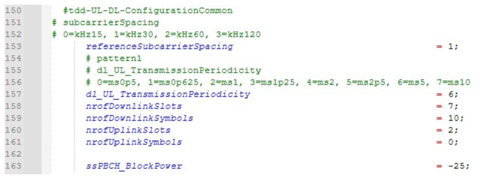

Wireless Scenario Configuration
The table below summarizes the wireless scenario and associated gNB and UE configuration used in the demo setup. The experiment is simplified to a single link between one base station and one user equipment, without interference from neighboring cells or other users.
The system operates in 3GPP NR band n78 with a 40 MHz bandwidth and a subcarrier spacing of 30 KHz using CP-OFDM modulation. A total of six PRBs are scheduled per UE, corresponding to an effective transmission bandwidth of approximately 2.16 MHz.
The TDD frame structure follows a 5 ms periodicity, with 7 downlink slots and 6 additional downlink symbols, complemented by 2 uplink slots and 4 uplink symbols. Uplink transmissions employ PUSCH mapping type B, spanning 13 OFDM symbols. DMRS pilot signals are configured as Type 1 with an additional position pos2, leading to DMRS placement at OFDM symbols 0, 5, and 10.
This baseline configuration provides a controlled environment for evaluating the fundamental link performance of the testbed.
| Parameter | Configuration |
| Wireless Scenario | Single link between one BS (gNB) and one UE No interference from neighboring cells or other UEs |
| Config File | gnb.band78.sa.fr1.106PRB.1x1.usrpx410_3300MHz.conf
| Operating Band | n78 |
| Waveform | CP-OFDM |
| Subcarrier Spacing (SCS) | 30 KHz |
| System Bandwidth | 40 MHz |
| Scheduled PRBs per UE | 6 |
| Scheduled Transmission Bandwidth | 2.16 MHz |
| TDD Pattern | DL/UL periodicity of 5 ms |
| Downlink Slots | 7 |
| Downlink Symbols | 6 |
| Uplink Slots | 2 |
| Uplink Symbols | 4 |
| PUSCH Mapping | Type B, duration = 13 OFDM symbols |
| PUSCH DMRS Configuration | Type 1, dmrs-AdditionalPosition = pos2 DMRS in OFDM symbols 0, 5, and 10 |

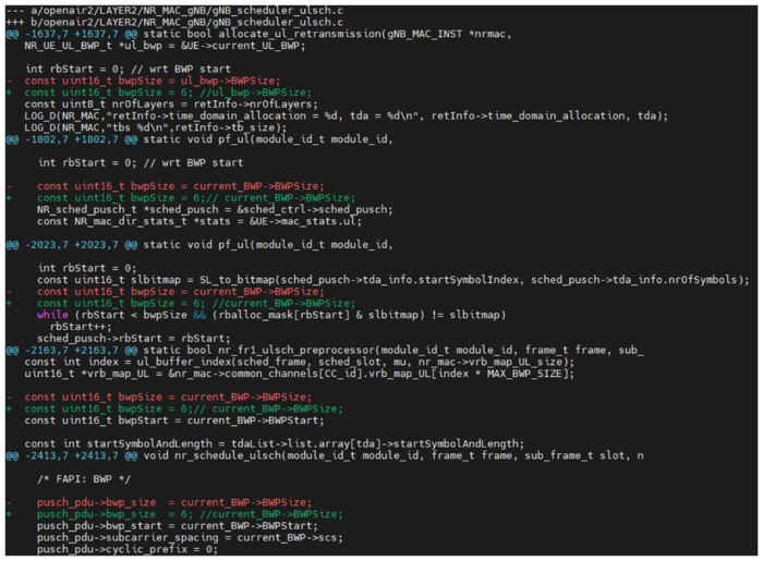

- Fix no. of PRBs to 6
- Fix TDD pattern to 2 uplink slots only

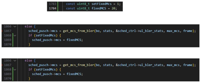

- Fix MCS to 20
- Set route from UE to CN for VLC UDP video streaming
Fix number of PRBs to 6
- Hard coded here
openair2/LAYER2/NR_MAC_gNB/gNB_scheduler_ulsch.c
- Added some prints
openair1/PHY/NR_TRANSPORT/ni_nr_ulsch_demodulation_neural_receiver.c
openair1/PHY/NR_TRANSPORT/nr_ulsch_demodulation.c
Configured via gNB config file gnb.band78.sa.fr1.106PRB.1x1.usrpx410_3300MHz.conf
Fix MCS to 20
- Hardcoded in this function:
