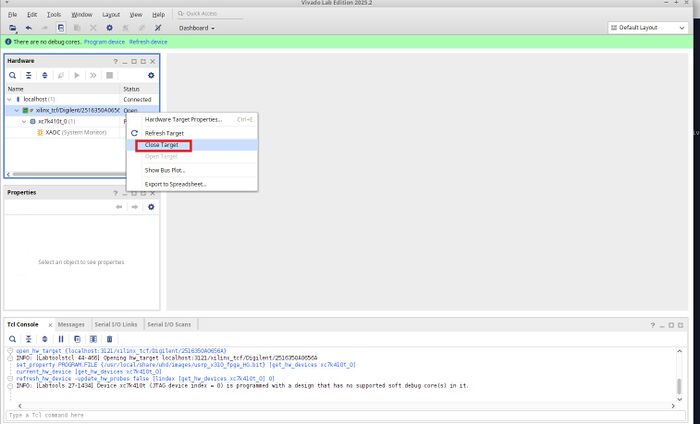

Once the programming is completed, close Vivado Lab.
Note: If Vivado is actively attached to the USRP (auto-connect is enabled for the specific target), then at USRP power cycle Vivado will stop the USRP from auto-loading whatever FPGA image is stored on it.
Note: Do NOT power-cycle the device at this stage since it’s the temporary image. Flashing the FPGA image via JTAG only does not write the FPGA image to EEPROM, you must run the uhd_image_loader to write the FPGA image to the internal EEPROM.
