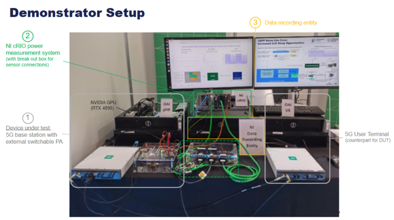

Device Under Test (DUT)
The system under test is an open, software-defined 5G base station prototype, constructed from the following components:
  • Linux server — serving as the baseband processing platform
  • OpenAirInterface (OAI) — open-source 5G NR base station stack
  • NI USRP X410 — software-defined radio acting as the RF front-end and transceiver

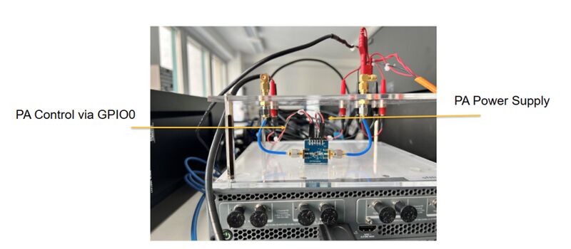

  • External switchable Power Amplifier (PA) — controllable in real time from the base station stack via the USRP GPIO interface
This prototype architecture is representative of emerging open RAN deployments and provides full software-level observability and modifiability of the base station's MAC, PHY, and RF layers — a prerequisite for the energy optimization use cases demonstrated here.

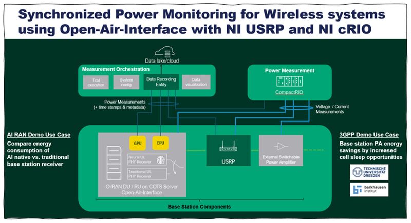

Measurement Framework Architecture
The measurement framework consists of two principal subsystems:

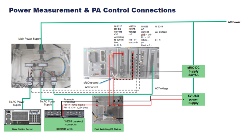

1. NI CompactRIO (cRIO) Scalable Acquisition System
The cRIO platform provides high-fidelity, multi-channel acquisition of voltage and current at each major power domain of the base station DUT. Sensor connectivity is realized as follows:
  • AC voltage and current sensors are connected via a breakout box to the power supplies of the base station server and the NI USRP
  • DC voltage and current sensors are connected to the power supply of the external PA
Instantaneous component power is derived continuously from these sensor readings, enabling time-resolved power profiling at each subsystem boundary.
2. Central Data Recording and Synchronization Entity
A dedicated Linux server acts as the central data recording entity. It aggregates power measurements from the cRIO acquisition system and from embedded power sensors within the base station components — including GPU and CPU power monitors in the base station server, and an onboard power sensor within the USRP.
A key capability of this entity is multi-source time synchronization: all power measurements, regardless of sensor origin, are timestamped and aligned to a common time grid corresponding to the 500 µs slot boundary of the 5G NR radio frame. This slot-aligned synchronization enables direct correlation between MAC-layer scheduling decisions and the resulting power consumption at each hardware component.

Real-time PA control PA switching driven directly by OAI MAC scheduler via USRP GPIO

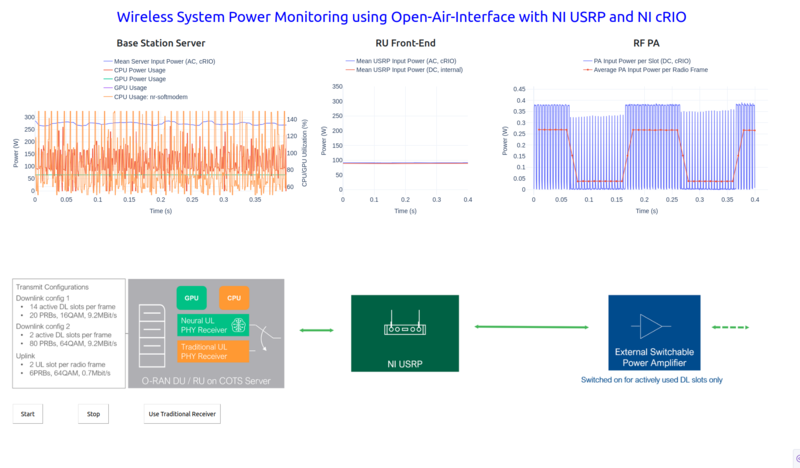

Use Case 1 — 3GPP-Aligned: Energy Savings via Enhanced Cell Sleep Mechanisms
This use case demonstrates measurable power amplifier energy savings through dynamic slot-level PA gating, motivated by enhanced cell sleep mechanism studies actively discussed in 3GPP standardization and investigated by research partners including TU Dresden and the Barkhausen Institute.
The core principle is to optimize MAC-layer DL resource allocation for a given mean target throughput such that the number of actively transmitted DL slots is minimized. The PA is switched on exclusively during actively scheduled DL slots and switched off otherwise, thereby drastically reducing PA power consumption during idle DL transmission periods.
3GPP Demo Use Case — Increased Cell Sleep Opportunities. The diagram illustrates the impact of MAC resource allocation on PA energy consumption (Gearbox PHY). Baseline Config 1 activates the PA across all 7 DL slots per half-frame, while Optimized Config 2 restricts transmission to a single DL slot per half-frame using a wider bandwidth and higher MCS. The PA power consumption plot (right) shows the resulting ~7× reduction in average PA power per radio frame when switching from Config 1 to Config 2.
The DL and UL transmission parameters used in this experiment are configured in two places:
  • gNB Configuration File: gnb.sa.band78.fr1.106PRB.usrpx410_3300.conf — defines the carrier-level radio parameters (106 PRB carrier bandwidth, Band n78, 30 kHz SCS, TDD pattern)
  • PHY Test Scheduler: openair2/LAYER2/NR_MAC_gNB/gNB_scheduler_phytest.c — contains the hardcoded slot-level scheduling parameters including PRB allocation, MCS, slot bitmaps, and frame switching period, within the functions nr_preprocessor_phytest() (DL) and nr_ul_preprocessor_phytest() (UL)
Two DL transmission configurations are alternated every 10 radio frames to enable direct comparative measurement:
Parameter Baseline Configuration Optimized Configuration
Active DL slots per radio frame 14 (7 per half-frame) 2 (1 per half-frame)
Transmission bandwidth 20 PRBs 80 PRBs
Modulation and Coding Scheme MCS 15 MCS 23
gNB TX PA behavior when no active DL slot is present Off (not exercised for inactive DL slots in this configuration) Off
Measurement results show that the average PA power consumption per radio frame is reduced by approximately under the optimized configuration — consistent with the theoretical reduction factor derived from the ratio of active DL slots between the two configurations.
Use Case 2 — AI-RAN: Energy Profiling of AI-Native vs. Traditional Receiver
This use case quantifies the compute energy cost of integrating AI-native signal processing into the base station Physical layer. A real-time Neural Receiver is integrated into the OAI PHY layer and can be toggled at runtime against the traditional receiver implementation.
The Neural Receiver executes on an NVIDIA GPU co-located with the base station server to meet real-time latency constraints, while the traditional receiver runs on the multi-core CPU of the Linux server. The measurement framework captures total server input power, GPU power, and CPU power simultaneously, yielding the following representative measurements:
Metric Neural RX (GPU) Traditional RX (CPU-only)
Total server input power ~250 W ~200 W
GPU power consumption ~60 W ~10 W (idle)
CPU power consumption ~130 W ~130 W (unchanged)
The ~50 W reduction in GPU power when switching to the traditional receiver is directly reflected in the total server input power, confirming the framework's ability to accurately attribute component-level power contributions. The CPU power remaining approximately constant across both configurations is consistent with the OAI stack's default behavior of not applying dynamic compute power management.
Demonstrator System Architecture
The diagram presents a Demonstrator System Architecture used for power‑aware testing of a 5G/6G Base Station Prototype (gNB) and NI USRP. ​
The Device Under Test (DUT) consists of a baseband processing platform (CPU/GPU), power supply, and an OpenAirInterface-based 5G/6G stack, connected to NI USRP hardware and an external power amplifier. AC and DC power channels are instrumented to support synchronized power and energy measurements across system components.
NI CompactRIO Power Measurement System
  • cRIO Controller 9047 for power calculation and data aggregation
  • Measurement modules:
    • NI-9244 — AC voltage (400 Vrms)
    • NI-9238 — AC current (±500 mV)
    • NI-9229 — DC voltage (±60 V)
    • NI-9227 — DC current (5 Arms)
  • The scalable NI CompactRIO measurement system captures voltage and current across base station components and derives their instantaneous power consumption over time. Via a break-out box, AC voltage and current sensors are connected to the power supplies of the base station server and USRP. DC voltage and current sensors are connected to the power supply of the external PA.
NI Data Recording Entity / Server
The data recording entity collects power measurements from the NI CompactRIO system as well as from embedded sensors within base station components, including the USRP, GPU, and CPU. A key feature of this entity is the synchronization of all measurements to a common time grid, specifically the 500 µs slot duration of the 5G NR system. This synchronization is enabled by timestamps and additional metadata that are added to all power measurements.
5G User Terminal (UE)
The UE runs an open-source 5G stack from OpenAirInterface and communicates with the gNB via NI USRP hardware over a wired or wireless RF channel.

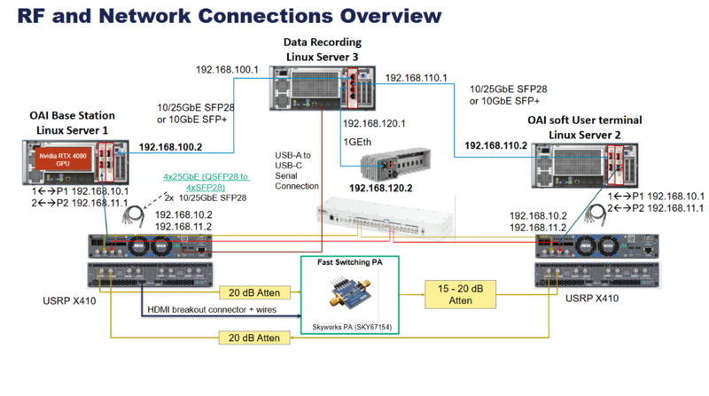

Power Monitoring Demonstrator – Bill of Materials
The Power Monitoring Demonstrator integrates high‑performance servers, SDR radios, RF components, and an NI CompactRIO measurement system to evaluate and monitor the power consumption of various wireless 5G/6G components. The following table lists all required hardware components. Where a specific model is listed, it reflects the configuration used in the demonstrator; equivalent hardware meeting the stated requirements may be substituted.
Equipment Requirements / Specifications Model Used in Demo Quantity
Server (gNB + UE + Data Recording)
  • Multi-core x86-64 processor, minimum 20 cores / 40 threads
  • Base clock ≥ 2.5 GHz, Turbo ≥ 4.5 GHz
  • TDP ≥ 200 W (high-performance workstation class)
  • Minimum 64 GB DDR5 ECC RAM
  • PCIe Gen 4 x16 slot (for GPU)
  • Minimum 2× PCIe x8 slots (for dual-port 25 GbE NICs)
  • Ubuntu 22.04 LTS compatible
Dell Precision 5860 Tower
Intel Xeon W7-2495X
(45 MB cache, 24 cores, 48 threads, 2.5 GHz to 4.8 GHz Turbo, 225 W)
3
Network Card (10GbE SFP+) Quad-port 10GbE SFP+, Linux driver support (i40e) Intel X710 Quad Port 10GbE SFP+ Adapter 1
Ethernet Cable (SFP+) 10G SFP+ DAC or optical, ≥ 2 m 10G Ethernet Cable SFP+ 2 m 2
SFP-to-RJ45 Adapter 1GbE SFP copper transceiver FCLF8522P2BTL 1
Network Card (25GbE SFP28) Dual-port 1/10/25GbE SFP28, Linux MLNX_OFED driver support Mellanox MCX512A-ACAT 4
QSFP28 → 4×SFP28 Breakout Cable 100GbE QSFP28 to 4×25GbE SFP28, ≥ 3 m NVIDIA MCP7F00-A003R26N
or NI PN 788214-01
2
NVIDIA GPU (Neural Receiver) NVIDIA GPU, CUDA 12.x compatible, ≥ 16 GB VRAM, PCIe Gen 4 x16 NVIDIA GeForce RTX 4090 Founders Edition 1
Extra GPU Power Cable 10‑pin to 8‑pin PCIe adapter
(not required for Dell Precision 5860 — onboard PCIe power sufficient)
COMeap 10‑pin to 8‑pin PCIe Cable 1
NI USRP NI USRP X410 (copper SFP28 interface, not fiber-optic variant) USRP X410 2
External Clock + PPS Source 10 MHz REF + PPS output, GPSDO or equivalent OctoClock‑G CDA‑2990 1
cRIO Power Measurement System NI CompactRIO chassis + AC voltage, AC current, DC voltage, DC current modules cRIO 9047 + NI‑9238, NI‑9244, NI‑9229, NI‑9227 1
RF Cables SMA(M)‑to‑SMA(M), 50 Ω, ≥ 1 m Standard SMA(M)‑to‑SMA(M) RF Cables (1 m) 7
20 dB RF Attenuators SMA‑F to SMA‑M, 20 dB fixed, 50 Ω, ≥ 2 W SMA‑F to SMA‑M Fixed Attenuators 2
10 dB RF Attenuators SMA‑F to SMA‑M, 10 dB fixed, 50 Ω, ≥ 2 W SMA‑F to SMA‑M Fixed Attenuators 2
Switchable Power Amplifier Fast-switching RF PA, GPIO-controllable enable pin, n78 band compatible Skyworks SKY67154 1
AC Current Clamps Split-core AC current transformer, ≥ 20 A range, cRIO compatible Magnelab SCT‑0750‑020 2
HDMI Breakout Connector 19‑pin HDMI Type A terminal block adapter (GPIO signal routing only) 19‑pin HDMI Terminal Block Adapter 1
USB‑C to USB‑A Cable Standard USB 2.0 or above, ≥ 1 m Standard 1
Network Switch (Optional) ≥ 4 × 1GbE ports, unmanaged or managed (for demo / remote access) Any compatible 4+ port switch 1
1G Ethernet Cables Standard Cat5e or above, RJ45 Standard 4

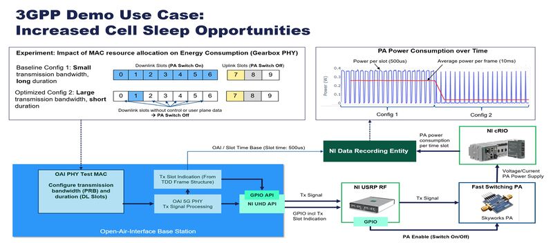

Hardware System Block Diagram Explanation
The diagram shows a full hardware setup for a 5G/6G research testbed.
The following sections describe the hardware setup component by component, followed by step-by-step connection instructions for each subsystem.

Fast Switching Power Amplifier (Skyworks SKY67154)
The Skyworks SKY67154 is a fast-switching PA placed between the two 20 dB RF attenuator stages in the RF chain. Important: this PA provides no RF gain control — it is used exclusively to emulate RF switching on/off for the cell sleep mechanism demonstration. Connect it as follows:
  1. Mount the PA between the two 20 dB SMA attenuators in the RF chain.
  2. Connect the DC power supply to the PA board power input.
  3. Connect DC voltage and current sensors to the PA power supply lines and route them to the NI cRIO DC input modules:
    • NI-9238 — DC voltage
    • NI-9229 — DC current
  4. Verify the HDMI breakout connector wiring (Pin 16 control, Pin 17 ground) matches the PA enable logic before powering on.

Summary of RF Connections and Control Connections
The RF connections between the two NI USRP X410 units are routed through fixed attenuators and the Fast Switching PA. The PA is present in the downlink path only. The uplink path uses a direct attenuated connection with no PA.
Downlink (gNB TX → UE RX)
NI USRP X410 — RF0/TX1 (gNB, Server 1)
    └──► SMA cable
              └──► 20 dB Attenuator
                        └──► Fast Switching PA (Skyworks SKY67154)
                        │    [PA enable controlled via GPIO0 over HDMI breakout — see Section 2.3]
                                       └──► NI USRP X410 — RF0/RX2 (UE, Server 2)
Uplink (UE TX → gNB RX)
NI USRP X410 — RF0/TX1 (UE, Server 2)
    └──► SMA cable
              └──► 20~30 dB Attenuator
                        └──► NI USRP X410 — RF0/RX2 (gNB, Server 1)
External Clock and Synchronization
  1. Connect the OctoClock-G CDA-2990 10 MHz REF output to the REF IN port of both USRP X410 units.
  2. Connect the PPS output of the OctoClock-G to the PPS IN port of both USRP X410 units.
  3. Verify both USRPs report clock lock before launching the OAI software stack.
Network connection and IP configurations
This section describes the Ethernet connections and IP address configurations required to bring up the testbed. It focuses on network and control interfaces and does not include power or RF cabling. It covers:
System Network and High-Speed Links
USRP to Server Links
  1. gNB USRP X410 → Linux Server 1: QSFP28 to 4×SFP28 breakout cable, 4×25 GbE (Mellanox MCX512A-ACAT NIC on server side).
  2. UE USRP X410 → Linux Server 2: QSFP28 to 4×SFP28 breakout cable, 4×25 GbE (Mellanox MCX512A-ACAT NIC on server side).
Data Recording Server Links
  1. Linux Server 3 → NI cRIO 9047: 1 GbE Ethernet (dedicated power measurement data only).
  2. Linux Server 3 → Linux Server 1 (gNB): 10 GbE SFP+ (Intel X710 quad-port NIC).
  3. Linux Server 3 → Linux Server 2 (UE): 10 GbE SFP+ (Intel X710 quad-port NIC).
  4. Linux Server 3 → PA control board: USB-A to USB-C serial cable.
Network Interfaces
Server 1 ↔ Server 3 (Management / Data)
Parameter Value
Server 1 IP 192.168.100.2
Server 3 IP 192.168.100.1
Link Type 10/25GbE SFP28 or 10GbE SFP+
Server 2 ↔ Server 3 (Management / Data)
Parameter Value
Server 2 IP 192.168.110.2
Server 3 IP 192.168.110.1
Server 1 ↔ USRP X410 (Fronthaul)
Parameter Value
Server 1 IPs 192.168.10.2 / 192.168.11.2
USRP X410 IPs 192.168.10.1 / 192.168.11.1
Link Type 4×25GbE QSFP28 → 4×SFP28
Server 2 ↔ USRP X410 (Fronthaul)
Parameter Value
Server 2 IPs 192.168.10.2 / 192.168.11.2
Server 3 ↔ NI cRIO
Parameter Value
Server 3 IP 192.168.120.1
NI cRIO IP 192.168.120.2
Link Type 1GbE + USB-A → USB-C Serial

The diagram shows the Power Measurement and PA Control Connections.
This section describes the power supply connections, measurement wiring, and PA control signal connections for the Power Monitoring Testbed. System component descriptions are covered in the Hardware Components section above — this section focuses exclusively on the connections and additional power supply details required to realize the measurements.
1. Power Supply Connections
Each testbed subsystem is powered independently. The table below lists the power supply type and ratings for each subsystem and identifies which are included in the measurement chain.
Subsystem Supply Type Voltage / Current Rating Included in Measurement?
Base Station Server (gNB) AC Mains 230V AC Yes
NI USRP X410 (RU) AC Mains 230V AC Yes
Fast Switching PA Fixture (Skyworks SKY67154) USB Power Supply (DC) 5V DC Yes
NI cRIO 9047 Chassis Dedicated DC Power Supply 24V / 5A DC No — power connection only
UE Server + UE USRP X410 AC Mains 230V AC No — not monitored in this configuration
Note: The NI cRIO chassis and UE subsystem are powered independently from the measurement chain. Their power consumption is not captured by the measurement framework in this configuration.
2. Power Measurement Connections
2.1 AC Current and Voltage Measurement — gNB Server and NI USRP X410
AC current is measured indirectly using Magnelab SCT-0750-020 split-core current transformer clamps (current clamps). Each clamp is placed around the AC supply cable of the device to be measured and converts the AC line current to a low-level voltage signal that is connected to the NI-9238 AC current input module in the cRIO chassis.
AC voltage is measured directly across the L1 (Live) and N (Neutral) terminals of the main AC supply and connected to the NI-9244 AC voltage input module.
Make the following connections:
  1. Clamp a Magnelab SCT-0750-020 current clamp around the AC supply cable of the gNB Base Station Server.
    Connect the clamp output to NI-9238 Ch0: White → 0+ / Black → 0−.
    Ensure the clamp is oriented in the correct direction relative to current flow to obtain a positive reading.
  2. Clamp a second Magnelab SCT-0750-020 current clamp around the AC supply cable of the NI USRP X410 (RU).
    Connect the clamp output to NI-9238 Ch1: White → 0+ / Black → 0−.
  3. Connect the L1 (Live) and N (Neutral) terminals of the main AC supply directly to the NI-9244 input terminals for AC voltage measurement.
Important: The NI-9238 does not connect directly to the AC power line. It measures only the low-level output signal of the Magnelab current clamp. Never connect the AC power line directly to the NI-9238 input terminals.
2.2 DC Current and Voltage Measurement — Fast Switching PA Fixture
DC current and voltage are measured directly on the 5V PA supply lines using inline connections to the NI-9227 and NI-9229 modules. No external transducer is required.
  1. Connect the 5V USB power supply output inline through NI-9227 Ch0 for DC current measurement.
    Orient the connection according to current flow direction: 0+ to 0−.
  2. Connect the PA board supply voltage to NI-9229 Ch0 for DC voltage measurement.
    Red → 0+ / Black → 0−.

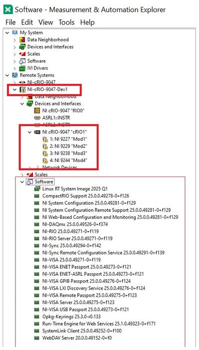

2.3 NI cRIO Measurement Module Connection Summary
Slot Module Measurement Connected To Transducer
1 NI-9227 DC current — PA supply (Ch0) 5V PA supply line (inline) None — direct connection
2 NI-9229 DC voltage — PA supply (Ch0) 5V PA supply terminals None — direct connection
3 NI-9238 AC current — gNB server (Ch0)
AC current — USRP X410 RU (Ch1)
Output of Magnelab SCT-0750-020 current clamp (one per channel) Magnelab SCT-0750-020 split-core current clamp
4 NI-9244 AC voltage — main supply (L1, N) AC mains L1 and Neutral terminals None — direct connection
3. PA Control Signal Connections
The Fast Switching PA is controlled in real time by GPIO0 of the NI USRP X410 (RU), routed via the HDMI breakout connector. The signal is synchronized to the 5G NR TDD frame timing, switching the PA on/off in alignment with gNB DL transmission slots.
Figure: Fast Switching PA Fixture (Skyworks SKY67154) mounted on top of the NI USRP X410. PA control signal routed via GPIO0 over HDMI breakout connector (left arrow). DC power supply connected directly to the PA board (right arrow).
  1. Connect the HDMI breakout connector to the GPIO header of the NI USRP X410.
  2. Connect Pin 16 of the HDMI breakout to the V_EN (PA enable) input of the PA board using a red wire.
  3. Connect Pin 17 of the HDMI breakout to the GND of the PA board using a black wire.
HDMI Pin Signal Wire Color Description
Pin 16 V_EN (GPIO0) Red 3.3V PA enable signal — logic low = PA on / logic high = PA off (active-low enable)
Pin 17 GND Black Ground reference for the GPIO enable signal

3 NI cRIO CompactRIO Chassis See Section 3.3 below
4 Data Recording Server Linux Server 3 See Section 3.4 below
Software Installation Summary
Entity Server OS Key SW Components GPU Required
OAI gNB + Neural Rx Server 1 Ubuntu 22.04.5 UHD 4.8, CUDA 12.2, TF 2.14, OAI gNB, FlexRIC, xApp Yes — RTX 4090
OAI UE Server 2 Ubuntu 22.04.5 UHD 4.8, OAI nrUE Optional
NI cRIO cRIO Chassis NI Linux Real-Time NI-RIO, NI-DAQmx, LabVIEW RT App No

Configure all network interfaces on each Linux server with static IP addresses corresponding to the system block diagram. Two methods are available depending on whether the user has local (physical) or remote (terminal-only) access to the machine.
Important: Pay attention to the NIC port number and its corresponding IP address. For multi-port NICs, Ubuntu Desktop GUI lists ports from top (port 1) to bottom (port N). On the physical NIC card, ports are typically numbered right to left. Confirm correct IP settings after configuration by running:
ifconfig
Option A — Ubuntu Desktop GUI (Network Manager)
This is the recommended method when a screen, keyboard, and mouse are available. The user must connect peripherals to each machine at least once to complete initial network configuration.
  1. Open Settings → Network on the Ubuntu Desktop.
  2. Select the network interface to configure and click the gear icon (settings).
  3. Navigate to the IPv4 tab.
  4. Set the method to Manual.
  5. Enter the static IP address, subnet mask, and gateway as listed in the system block diagram for that interface.
  6. Click Apply and toggle the interface off and on to activate the new settings.
  7. Verify the configuration:
    ifconfig
Note: The Network Manager GUI method is straightforward and does not require command-line editing. No further explanation of the GUI itself is provided here.
Option B — Netplan via Terminal (Remote or Headless Access)
Use this method if the machine cannot be accessed locally (e.g., no screen available) or if a terminal-based configuration is preferred. Netplan is the default network configuration tool on Ubuntu 20.04 and later. Ensure the Netplan renderer is set to NetworkManager or networkd as appropriate for the system.
Step 1 — Identify the Netplan configuration file:
ls /etc/netplan/
The default file is typically named 01-network-manager-all.yaml.
Step 2 — Back up the current configuration:
sudo cp /etc/netplan/01-network-manager-all.yaml \
        /etc/netplan/01-network-manager-all_backup.yaml
Step 3 — Open the configuration file for editing:
sudo nano /etc/netplan/01-network-manager-all.yaml
Step 4 — Update the Netplan configuration.
The example below shows the static IP configuration for the Base Station Server (Linux Server 1). Adapt interface names and IP addresses for each server according to the system block diagram:
network:
  version: 2
  renderer: NetworkManager
  ethernets:
    enp<usrp_iface>:                  # Interface connected to gNB USRP X410
      dhcp4: no
      addresses:
        - 192.168.10.1/24             # Adapt per system block diagram
    enp<ue_server_iface>:             # Interface connected to UE server / data network
      dhcp4: no
      addresses:
        - 192.168.11.1/24            # Adapt per system block diagram
    enp<crio_iface>:                  # Interface connected to NI cRIO 9047
      dhcp4: no
      addresses:
        - 192.168.100.2/24            # Adapt per system block diagram
Note: Netplan YAML files are sensitive to indentation and formatting. Use spaces (not tabs) for indentation. Incorrect formatting will prevent the configuration from being applied.
Step 5 — Save and close the file (Ctrl+O to save, Ctrl+X to exit nano).
Step 6 — Apply the new configuration:
sudo netplan apply
Step 7 — Verify the IP settings:
ifconfig
Step 8 — Confirm connectivity to all nodes:
ping 192.168.10.2      # gNB USRP X410
ping 192.168.11.2     # UE Server (Linux Server 2)
ping 192.168.100.1     # NI cRIO 9047

  9. Wait for NI MAX to complete the software installation on the cRIO. After completion, verify the following software components appear under the Software tab of the cRIO target in NI MAX:
    Software Component Version
    Linux RT System Image 2025 Q1 25.0.0
    CompactRIO Support 25.0.0
    NI System Configuration 25.0.0
    NI-DAQmx 25.0.0
    NI-RIO Server 25.0.0
    NI-VISA 25.0.0
    NI Sync 25.0.0
    SystemLink Client 25.0.0
Note on password setup: If you encounter issues setting the administrator password during this step, finalize the software installation first and set the password afterwards via NI MAX → System Settings → Set Permissions on the Windows PC.
Note on subsequent steps: After the base image installation is complete, all remaining cRIO configuration steps (module renaming, network settings, firmware update) are also performed via NI MAX on the Windows PC. The Python software deployment steps that follow (Sections 3.3.5 onwards) are performed from Linux Server 3 via SSH.
And the following C Series modules should appear under the cRIO chassis:
Slot Module Assigned Name
1 NI 9227 NI-9227
2 NI 9229 NI-9229
3 NI 9238 NI-9238
4 NI 9244 NI-9244
Output of NI MAX. ​

With the gRPC server running on the cRIO, run the Jupyter notebook example on the Host PC:
energy_efficiency_grpc_client_basicVisualizationExample.ipynb
This can be opened using:
  • Visual Studio Code with the Python virtual environment activated
  • Jupyter web server
A successful run will produce a real-time power measurement plot showing:
Trace Color Measured Entity
rf_pa_power (mW) Blue Power Amplifier (PA)
server_power_total Red gNB Server
ru_power_total Green USRP (RU)
The plot displays power in Watts over time (seconds), with the PA showing TDD burst patterns and the server and USRP showing stable DC power consumption levels. ​

Get the USRP Serial Connection ID
The data recording application reads power measurements from the USRP X410 embedded sensor via a USB serial connection. Follow the steps below to identify the correct serial connection ID.
Prerequisites:
  • Ensure the base station USRP X410 and the Data Recording Server are both powered on.
  • Ensure the USB-C to USB-A cable between the USRP X410 and Server 3 is connected
as described in the Network Connections section.
Step 1: Log in to the Data Recording Server and open a terminal.
Step 2: Run the following command to list USB serial devices:
ls /dev/serial/by-id
The output will look similar to this (exact names may differ by OS version):
usb-Digilent_Digilent_USB_Device_2516353B3AD9-ifO0-port0
usb-Digilent_Digilent_USB_Device_2516353B3AD9-ifO2-port0
usb-Digilent_Digilent_USB_Device_2516353B3AD9-ifO1-port0
usb-Digilent_Digilent_USB_Device_2516353B3AD9-ifO3-port0
Step 3: Identify the entry with postfix if03. The alphanumeric string before the postfix is the required serial connection ID.
In the example above, the serial connection ID is: 2516353B3AD9
Step 4: Copy this ID into the JSON data recording configuration file under power_measurement_service_addresses → usrp_sensors: The configuration file is located at:
data_recording_app/config/config_data_recording_local_mode_pow_meas.json
"power_measurement_service_addresses": {
    "base_station": {
        "server_internal_sensors": "192.168.100.2:2031",
        "crio_sensors": "192.168.120.2:2032",
        "usrp_sensors": "2516353B3AD9"

As described earlier, the synchronized data recording framework can collect and align measurements from multiple sources, including:
  • power measurements from the cRIO system,
  • CPU and GPU power and utilization measurements from the base station server,
  • measurements from internal USRP sensors, and
  • 5G NR messages and data traced from the real-time OAI gNB and UE stacks.

ricAddress RIC address: 192.168.100.2:5000
tracer_service_baseStation_address T-Tracer address for base station: 192.168.100.2:2031
tracer_service_userEquipment_address T-Tracer address for UE: 192.168.110.2:2031
power_measurement_service_addresses → base_station → server_internal_sensors 192.168.100.2:2031
power_measurement_service_addresses → base_station → crio_sensors 192.168.120.2:2032
power_measurement_service_addresses → base_station → usrp_sensors USRP serial connection ID (e.g., 2516353274B01) — see Section 3.4.5

Power Monitoring GUI
Power Monitoring GUI — Demo Use Cases
The Power Monitoring GUI provides real-time visualization of power and energy consumption across all monitored hardware components of the testbed. The following subsections describe the expected GUI behaviour and power measurements for each of the two demonstration use cases. Both use cases operate using the customized OAI PHY Test MAC scheduler (gNB_scheduler_phytest.c), which alternates between two DL transmission configurations every 10 radio frames.
Use Case 1 — Energy Savings via Enhanced Cell Sleep Mechanisms
The first use case demonstrates the power savings achievable at the base station Power Amplifier by exploiting increased cell sleep opportunities — specifically by dynamically switching the PA off during slots where no DL transmission is required.
The PHY Test MAC scheduler alternates between the following two configurations every 10 radio frames:
Parameter Baseline Config 1 Optimized Config 2
Scheduled DL PRBs 20 PRBs 80 PRBs
MCS 15 23
PA state during inactive slots Off Off
Slot bitmap 130175 2050
In the Power Monitoring GUI, the following behaviour is expected during this use case:
  • The PA power trace (blue curve in the right plot) clearly shows two alternating patterns:
    • Config 1: PA switches on/off 14 times per radio frame (7 per half-frame)
    • Config 2: PA switches on/off only 2 times per radio frame (1 per half-frame)
  • The average PA power per frame (red curve) drops by approximately when switching from Config 1 to Config 2 — directly quantifying the energy saving achieved
  • The Base Station Server and RU (USRP X410) power traces remain largely unchanged between the two configurations, confirming that the energy saving is localized to the PA
Figure: Power Monitoring GUI during Use Case 1 — Enhanced Cell Sleep Mechanisms. The blue curve shows instantaneous PA power per 500 µs slot. The red curve shows average PA power per 10 ms radio frame. The transition from Baseline Config 1 (14 active DL slots per frame) to Optimized Config 2 (2 active DL slots per frame) produces an approximately 7× reduction in average PA power consumption.

Base Station Server Panel
The Base Station Server panel displays five traces:
Trace Color Description Observed Behavior
Mean Server Input Power (AC, cRIO) Blue Total AC input power to server measured by cRIO Stable ~250–300 W with slight variation
CPU Power Usage Orange CPU power draw from server internal sensor High variability ~100–250 W, spiky pattern due to active real-time baseband processing
GPU Power Usage Green GPU power draw (Neural Rx inference) Stable low level ~50–60 W
GPU Usage Purple GPU utilization percentage (%) Stable low percentage
CPU Usage: nr-softmodem Light Orange CPU utilization specifically from the nr-softmodem process High and variable, reflecting real-time PHY processing load
Key observation: The CPU power and usage traces show high variability and sustained load across the full measurement window, reflecting continuous real-time 5G NR physical layer processing by the nr-softmodem process.
RU Front-End Panel
Mean USRP Input Power (AC, cRIO) Blue Total AC input power to USRP X410 measured by cRIO 90 W
Mean USRP Input Power (DC, internal) Red DC power measured internally by USRP 88 W
Key observation: The USRP X410 power consumption is constant and stable, independent of the MAC scheduling activity, as the radio hardware remains continuously powered during operation.
RF PA Panel
PA Input Power per Slot (DC, cRIO) Blue Per-slot power consumption of the Skyworks SKY67154 PA measured by cRIO Dense high-frequency bursts up to ~0.38–0.40 W across nearly all DL slots
Average PA Input Power per Radio Frame Red Rolling average PA power per 10 ms radio frame Sustained high average ~0.25–0.27 W with only brief dips

Use Case: AI-Driven PA Energy Optimization (Yonsei University)
Overview
This section demonstrates the capabilities of the power measurement framework on an example AI RAN use case developed in collaboration with Yonsei University.
Yonsei University integrated an optimized Reinforcement Learning (RL)-based MAC scheduler into the base station stack. The scheduler optimizes resource allocation and with it usage and energy consumption of the base station power amplifier. The power measurement framework is used to measure and demonstrate the energy savings that can be obtained with this approach.
Use Case Description
Core Idea
The RL-based MAC scheduler addresses a fundamental energy efficiency challenge in base station operation: the RF Power Amplifier (PA) consumes significant power whenever it is active, regardless of how much data is actually being transmitted in a given slot.
The scheduler tackles this by optimizing MAC-layer DL resource allocation to minimize the number of actively used downlink (DL) slots for a given traffic profile. The PA is then:
  • Switched ON exclusively for slots carrying active DL transmissions
  • Switched OFF for all remaining slots — directly eliminating idle PA power consumption
Resource Allocation Strategy
Rather than transmitting packets immediately as they arrive — which activates the PA for every individual slot — the RL scheduler waits and accumulates packets before transmitting them together in a single DL slot.
This batching strategy reduces the total number of slots that require PA activation, concentrating transmissions into fewer, fuller slots and creating longer PA-off periods between them.
Trade-off: Latency vs. Energy
Batching transmissions inevitably introduces additional packet delay at the user side — packets must wait until enough data has accumulated before transmission begins. The RL approach is specifically designed to dynamically balance these two competing objectives based on the current traffic profile:
  • Minimizing active DL slots → reduces PA on-time → lower energy consumption
  • Minimizing packet delay → improves user experience → lower latency
Neither objective is fixed — the RL scheduler continuously adapts the transmission batching strategy in real time, trading off latency against energy savings according to the observed traffic load.
Observable Results
The effect of the RL-based MAC scheduler can be clearly observed in the Power Monitoring GUI (see Section 5) through three complementary plots. The GUI additionally allows the user to select different traffic profiles and, for each selected profile, to switch at runtime between the baseline MAC scheduler policy and the Reinforcement Learning MAC scheduling policy. By observing the PA power trend plot and the packet delay plot when toggling between the two scheduling policies, the respective PA energy savings and the associated packet delay differences can be directly derived and compared.
Power Monitoring GUI — AI-Driven PA Energy Optimization Use Case (Yonsei University / IEEE Globecom 2025). The GUI displays three plots: (1) PA power consumption per slot showing the switching pattern for the active scheduler policy and traffic profile, (2) PA power trend showing average PA energy consumption over longer time periods, and (3) packet delay distribution over time quantifying the latency trade-off. By switching between the baseline and RL MAC scheduling policies, PA energy savings and packet delay differences can be directly compared.
Plot What It Shows How to Use It
PA Power Consumption per Slot Shows the instantaneous PA power per 500 µs slot over time. The burst pattern reveals how long and how often the PA is switched on for the selected traffic profile and scheduler policy. With the baseline scheduler, PA bursts are frequent and densely distributed. With the RL scheduler, bursts are fewer and shorter — reflecting the batching of transmissions into fewer, fuller slots. Compare burst density and gap duration between the baseline and RL scheduler policies to visualize the reduction in PA active time.
PA Power Trend Shows the average PA power consumption over longer time periods — smoothing out individual slot bursts to reveal the overall PA energy consumption across multiple radio frames. This plot makes the sustained energy saving effect of the RL scheduler directly readable as a reduction in the mean PA power level. Switch between scheduler policies and observe the shift in the average PA power trend line — the magnitude of the drop quantifies the PA energy saving achieved by the RL scheduler for the selected traffic profile.
Packet Delay Distribution over Time Shows the effective packet delay distribution as a function of time. Delay increases when the RL scheduler accumulates packets before transmitting them in batches. The plot quantifies the latency trade-off that is the direct counterpart of the PA energy saving. Compare the packet delay profile between the baseline and RL scheduler policies — the difference in delay distributions quantifies the latency cost of the energy saving achieved by the RL scheduler.
By selecting a traffic profile in the GUI and toggling between the baseline MAC scheduler and the RL MAC scheduler, the user can directly read off from the PA power trend plot and the packet delay plot:
  • The PA energy saving achieved by the RL scheduler for that traffic profile — visible as a reduction in average PA power
  • The associated packet delay trade-off — visible as an increase in the packet delay distribution
  • The dynamic balance between both objectives as the RL scheduler adapts to the observed traffic load in real time
Demo Video
The video was created by the team of Prof. Chae at Yonsei University and is available on their official YouTube demonstration channel. A recorded demonstration of the AI-driven PA energy optimization use case, presented at IEEE Globecom 2025 (Taipei), can be accessed at the following link:
[[https://www.youtube.com/watch?v=jehh81Y4mPU IEEE Globecom 2025 — Energy-Efficient AI-RAN: Algorithms and Prototype Validation (NI and Yonsei University)]]
The video demonstrates the Power Monitoring GUI in live operation, showing real-time PA power consumption traces and packet delay measurements as the RL-based MAC scheduler dynamically adjusts DL slot usage to balance energy savings against packet latency.
