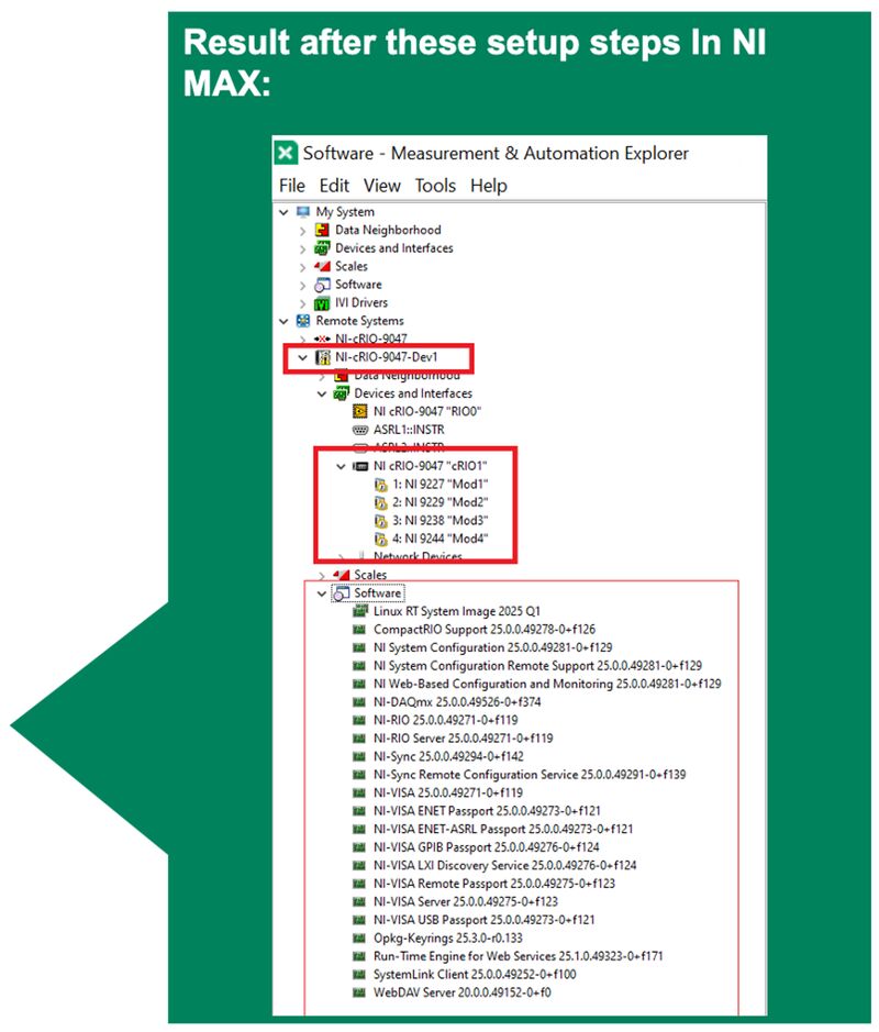

- 23.6.3 3.3.3 Rename C Series Modules in NI MAX
- 23.6.4 3.3.4 Network Adapter and User Settings

3.3 NI cRIO Software Installation
The NI CompactRIO (cRIO-9047) supports two installation methods for the Python-based gRPC server software: an automated deployment script (recommended) and a manual installation procedure. Both methods are described below.
For more details on general cRIO hardware setup, refer to the Getting Started with CompactRIO Hardware and LabVIEW guide.
3.3.1 cRIO System Preparation
- Download and install NI CompactRIO driver version 2025 Q1 from the NI CompactRIO Download page.
- Download and install Base Image 2025 Q1 from the NI Linux RT System Image Download page.
- In NI MAX, do step 4 up to Base Image installation — select Linux RT System Image 2025 Q1 (Version 25.0.0).
- After the automatic cRIO reboot, you will be asked to select a programming environment. Choose Other (…, Python, etc.).
- Keep the default software selections and click Continue.
Note: If you encounter issues setting the password, finalize the software installation first and set the password afterwards.
After completing these steps, NI MAX should show the cRIO target with the following software installed under the Software tab:
| Software Component | Version |
| Linux RT System Image 2025 Q1 | 25.0.0 |
| CompactRIO Support | 25.0.0 |
| NI System Configuration | 25.0.0 |
| NI-DAQmx | 25.0.0 |
| NI-RIO Server | 25.0.0 |
| NI-VISA | 25.0.0 |
| NI Sync | 25.0.0 |
| SystemLink Client | 25.0.0 |
And the following C Series modules should appear under the cRIO chassis:
| Slot | Module | Assigned Name |
| 1 | NI 9227 | NI-9227 |
| 2 | NI 9229 | NI-9229 |
| 3 | NI 9238 | NI-9238 |
| 4 | NI 9244 | NI-9244 |
The module names are used by the Python RT implementation to identify modules based on a JSON configuration file. Rename each module in NI MAX as follows:
- In NI MAX, expand the cRIO chassis node to show the installed modules.
- Right-click each module → Rename.
- Set the names exactly as shown in the table below.
| Slot | Module | Required Name |
To verify the module settings, click on each module in NI MAX and confirm:
- Program Mode: Real-Time (NI-DAQmx)
- Status: Present
